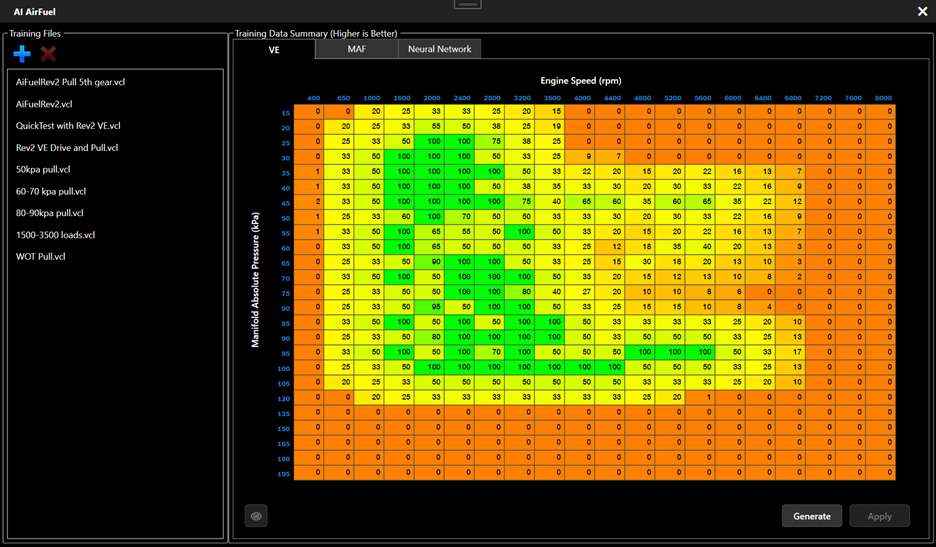

  7. Select ECU > AI AirFuel.
  8. Select the icon and select the VCL log file you just saved.
    • You can select multiple log files.
  9. Review the Training Data Summary and confirm that the logged data covers all desired engine speeds and loads. The higher the number, the better the samples are in that area.
    • It is completely acceptable to have some cells with low values. The neural network can fill in small gaps in the training data.
    • If some areas are missing samples, you can record another log file and add it to the list of training files.
