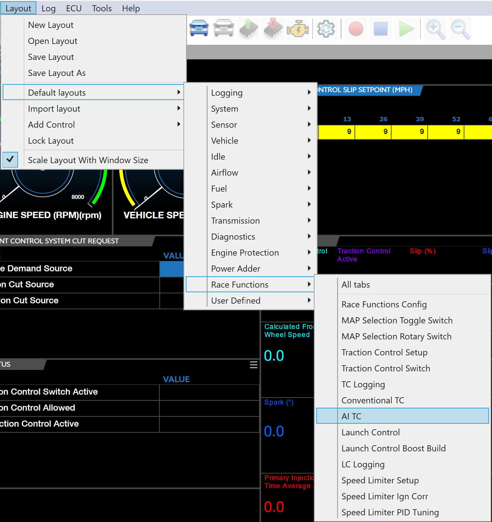

  1. Download the latest VCM Live (Beta) software.
  2. From the Menu Bar click Layout > Default Layout > Race Functions > AI TC.
  3. Ensure the below parameters are selected, then click Ok.
