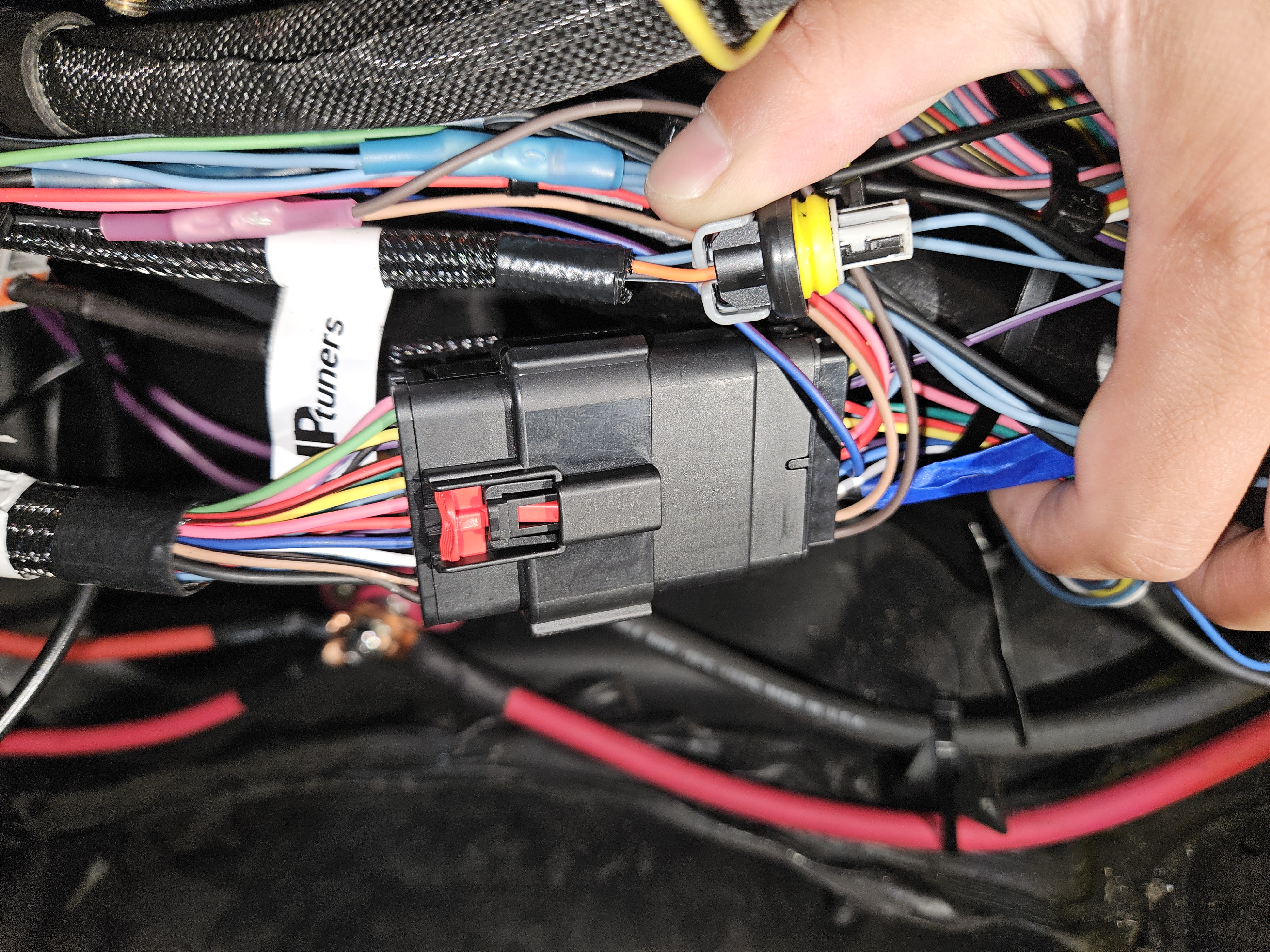

  1. Connect the I/O sub harness to your Drive-by-Cable or Drive-by-Wire harness.
  2. Mount your burnout control toggle, push-button, or momentary switch in your preferred location.
  3. Ground the black ground wire to the vehicle's chassis.
  4. Splice the burnout control toggle, push-button, or momentary switch signal wire to any of the available inputs from the I/O sub harness.
  5. Burnout control toggle, push-button, or momentary switch is now wired properly.

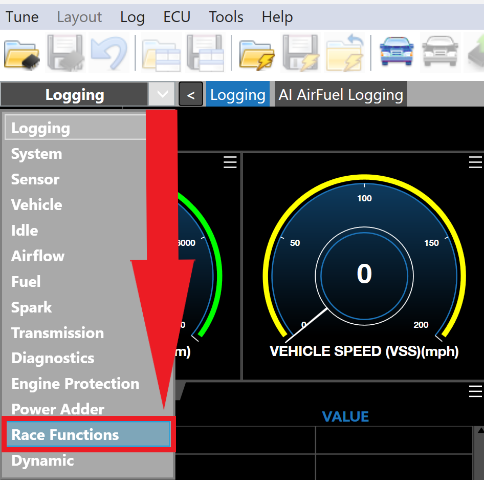

  2. Open VCM Live and click the drop down arrow in the group layout tab and select Race Functions.

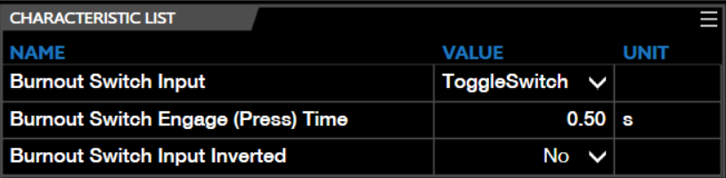

  3. In the Race Functions Config tab in the top menu bar locate the Burnout Control Enabled parameter and change the value to Yes.
  4. Select the Burnout tab in the top menu bar and locate the Burnout Control Lockout Time parameter and adjust the lockout time (in seconds) to your preferred value.
    A successful vehicle launch must be confirmed, and a configurable burnout control lockout timer must expire before burnout control is enabled.
  5. Locate all of the below parameters and change their values accordingly.
  6. Burnout control is now enabled. Use the section below to complete your configuration.

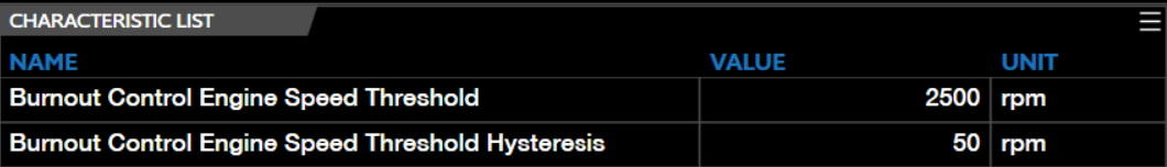

  1. Locate the Burnout Control Engine Speed Threshold & Burnout Control Engine Speed Threshold Hysteresis parameters to configure burnout rev limiter activation.
    When engine RPM reaches the defined threshold, CORE applies fuel cut, spark cut, or a combination of both to hold the target RPM.

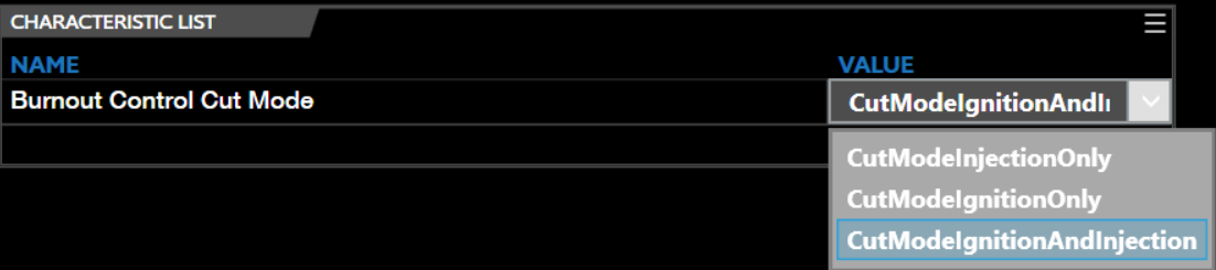

  2. Locate the Burnout Control Cut Mode parameter to configure the burnout rev limiter cut mode.
