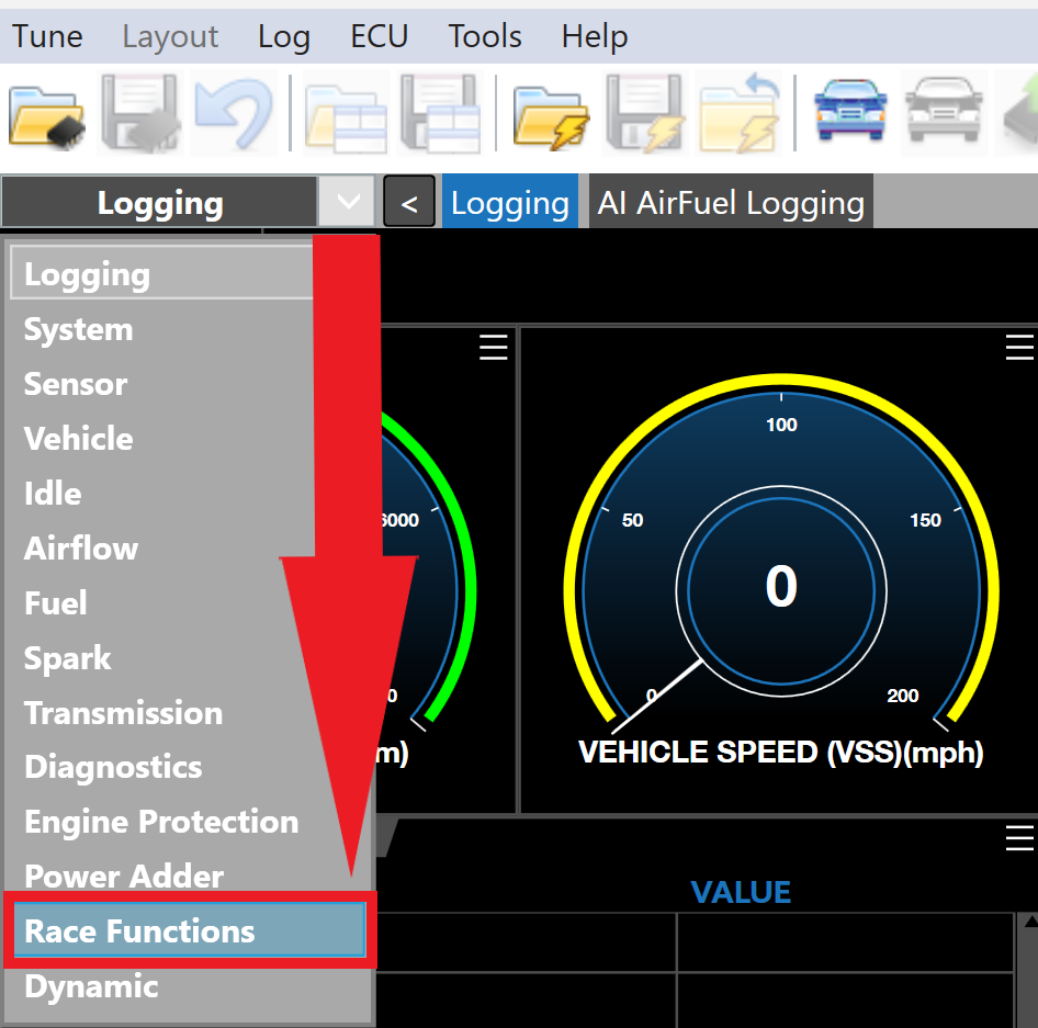

  2. Open VCM Live and click the drop down arrow in the group layout tab and select Race Functions.

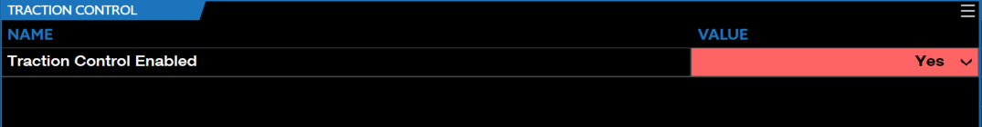

  3. Locate the Traction Control Enabled parameter and select Yes.

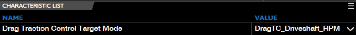

  6. Locate the Drag Traction Control Target Mode parameter and select your preferred method for controlling the traction control target.
    Drag TC offers two options to control your target mode: DragTC_Driveshaft_RPM & DragTC_Enginespeed_RPM.
