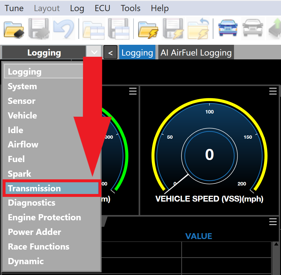

  2. Open VCM Live and click the drop down arrow in the group layout tab and select Transmission
