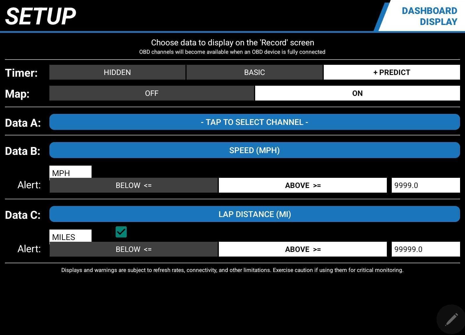

Setup Dashboard Display¶
Set lap timer and data channel displays to be shown when recording a session.
Timer¶
Three timer options are available for the dashboard display:
| Timer Option | Description |
| Hidden | Removes the timer from the display. |
| Basic | Is the default timer display option. |
| + Predict | Displays your best time and shows a live ± comparison against your current run. |
Map¶
The map display can be enabled or disabled.
Data A, B, & C¶
Users can select a data channel to display or disable the feature entirely.
An alert trigger can also be configured for the selected channel.
