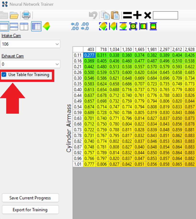

    • Note that each camshaft angle combination has a dedicated VE table, which may result in 25 or more VE tables total.
    • When Use Table for Training is enabled, the selected table is included in the training process. Using fewer tables can accelerate tuning but may reduce training accuracy. This option can also be used to exclude unused VE tables from training.
