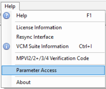

  4. Open VCM Editor, download the latest version of VCM Editor (if necessary).
  5. In the top menu bar in VCM Editor click Help > Parameter Access.
  6. Type the code within the Device Code tab, write a description if necessary.
  7. Click Link This Device.
  8. The status bar in the bottom of the parameter access window will turn green when completed.
