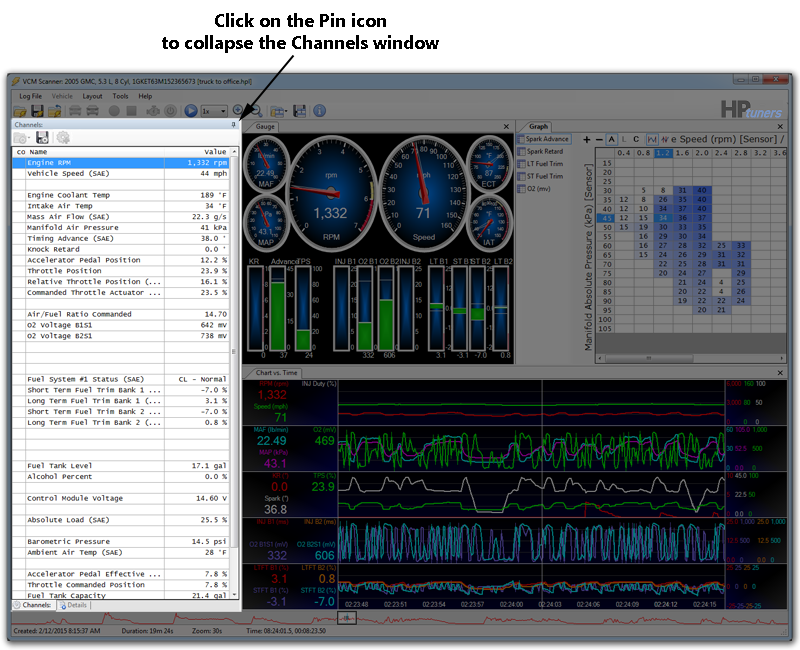

Channel Icons
The icons in the left column indicate the type of each channel:
Icon Description
A polled parameter - Although the vehicle's controller can provide this information, VCM Scanner has to ask the controller to provide it. This adds processing load to the system. So, adding a large number of these to the channel list could potentially slow down the rate at which scan data is received.
A broadcast parameter - The vehicle's controller is constantly broadcasting this parameter, whether VCM Scanner asks for it or not. Therefore, adding these to the channels list does not impact system performance.
An unsupported parameter - The controller in the current vehicle cannot provide this parameter.
An external input - The parameter is provided by an external device (typically a sensor) connected to your computer through one of the following:
- The computer's serial (or USB) port.
- The EIO Interface for an MPVI Pro.
- The Pro Link cable for an MPVI2.
- The Pro Link+ cable for an MPVI2+ and up.
External inputs do not impact system performance.
Click the pin icon to collapse the Channels window.
