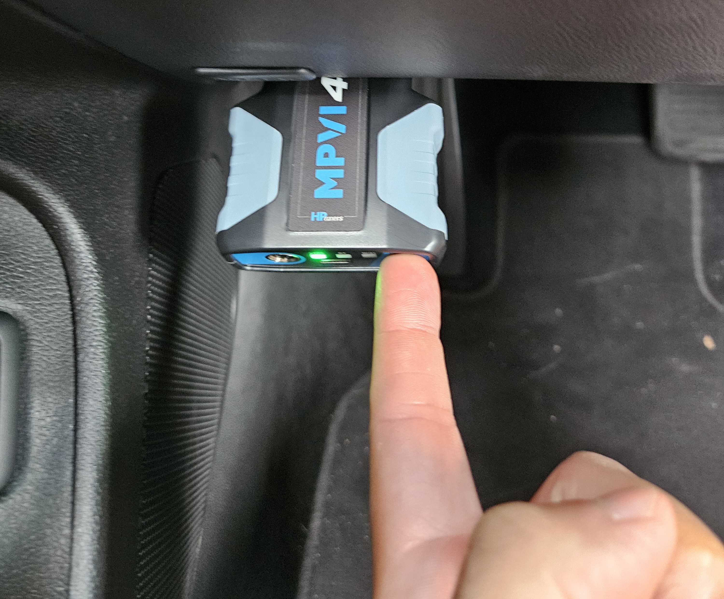

  1. Push the standalone datalog button on the MPVI/RTD device.

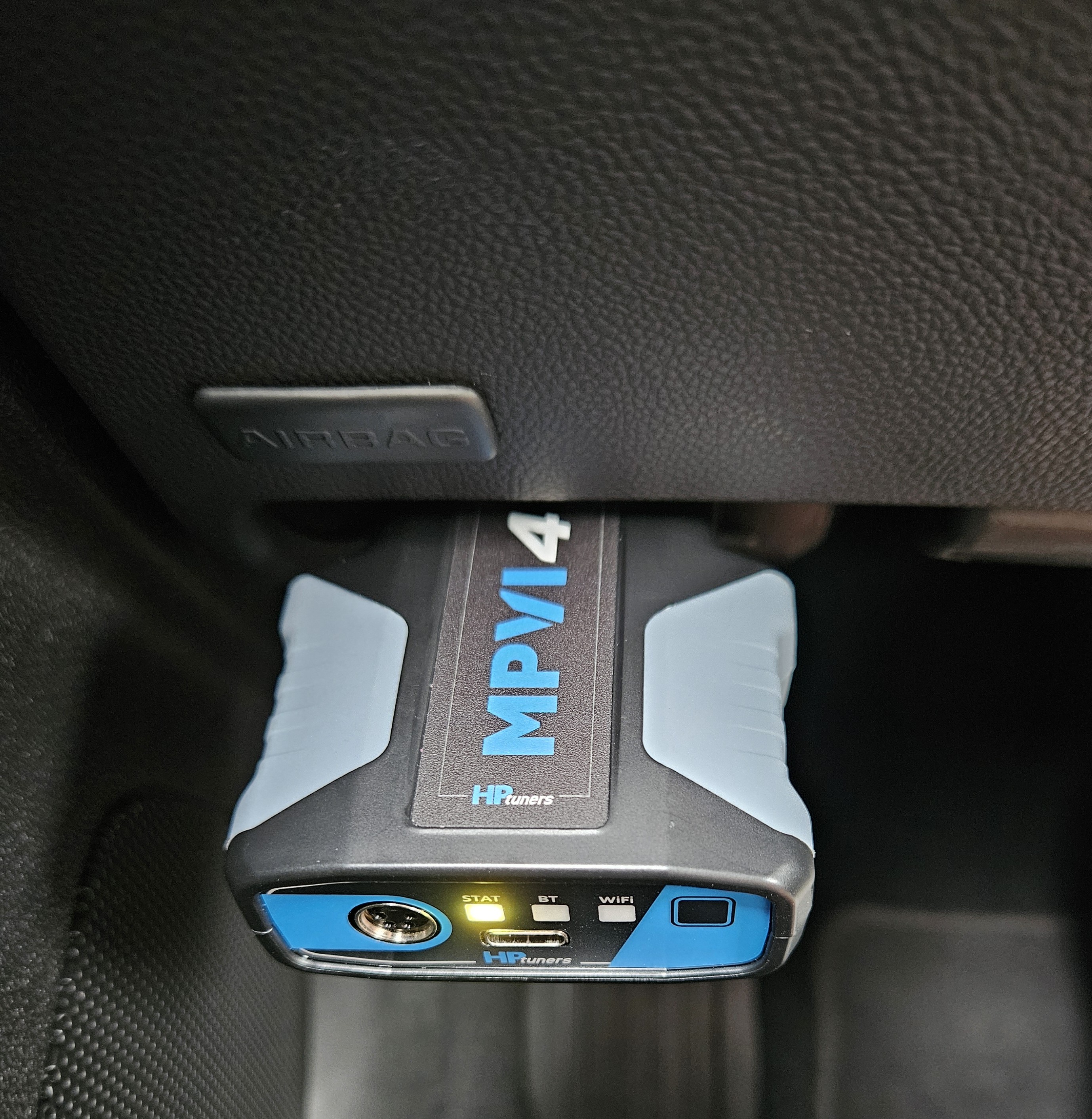

  2. Your MPVI/RTD device will begin blinking yellow indicating data is being pushed to Telemetry.

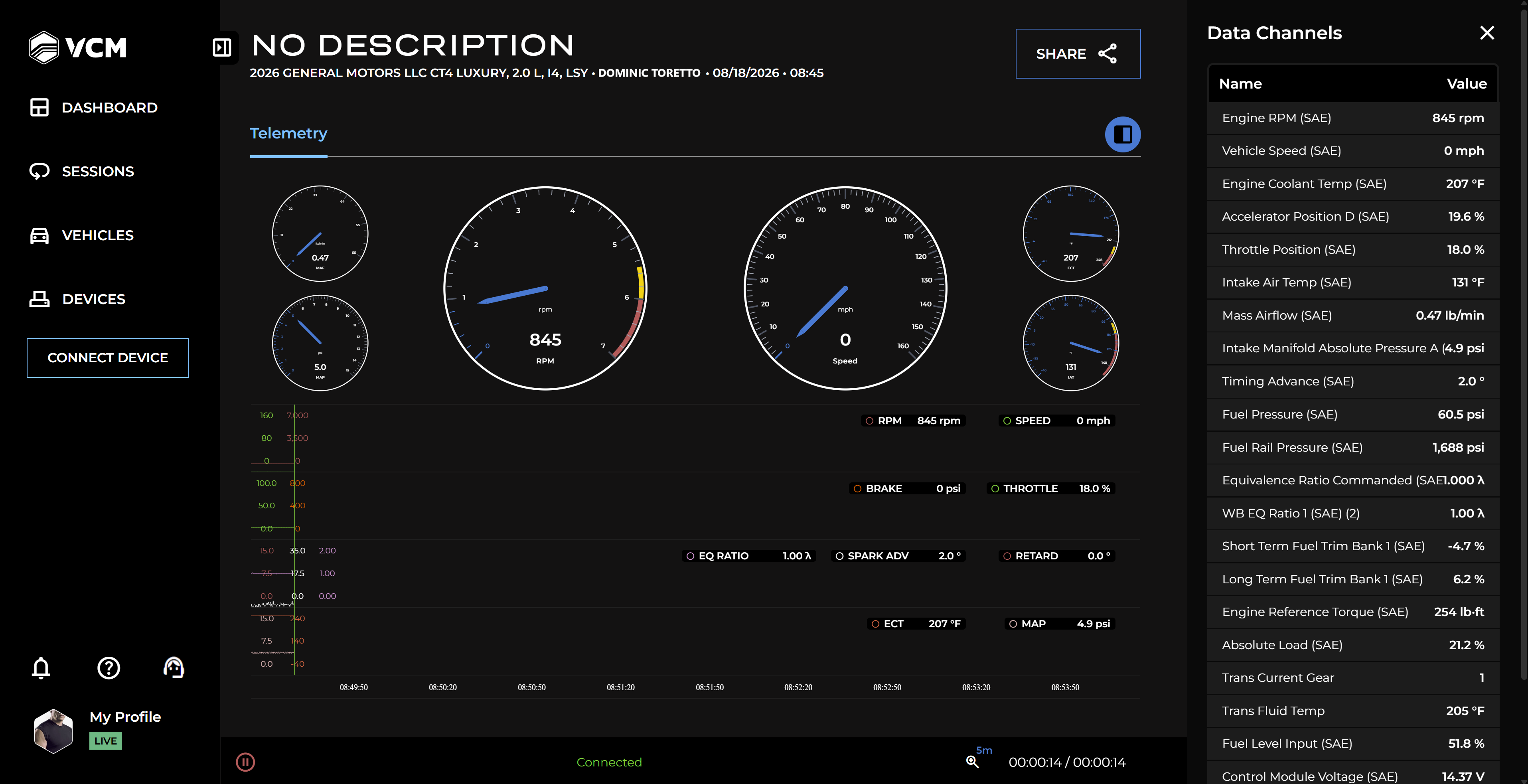

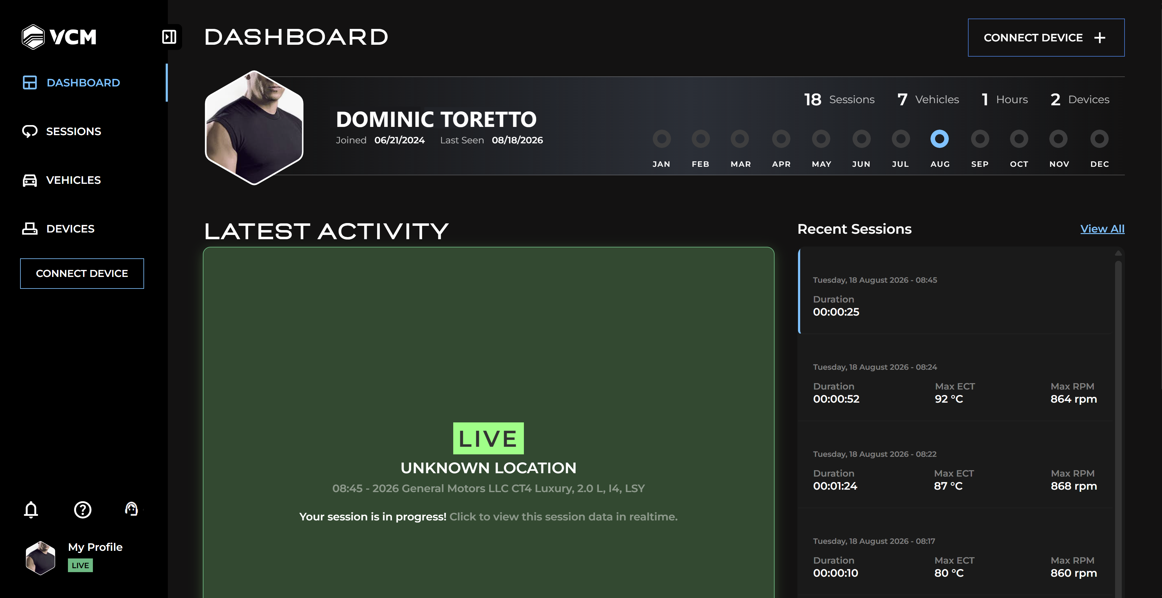

  3. Within the Telemetry site click on the DASHBOARD tab, under the LATEST ACTIVITY section you will see a LIVE session, click on that section to begin viewing the live data from your vehicle.
  4. The Live data session page will appear, begin driving to view your live data.

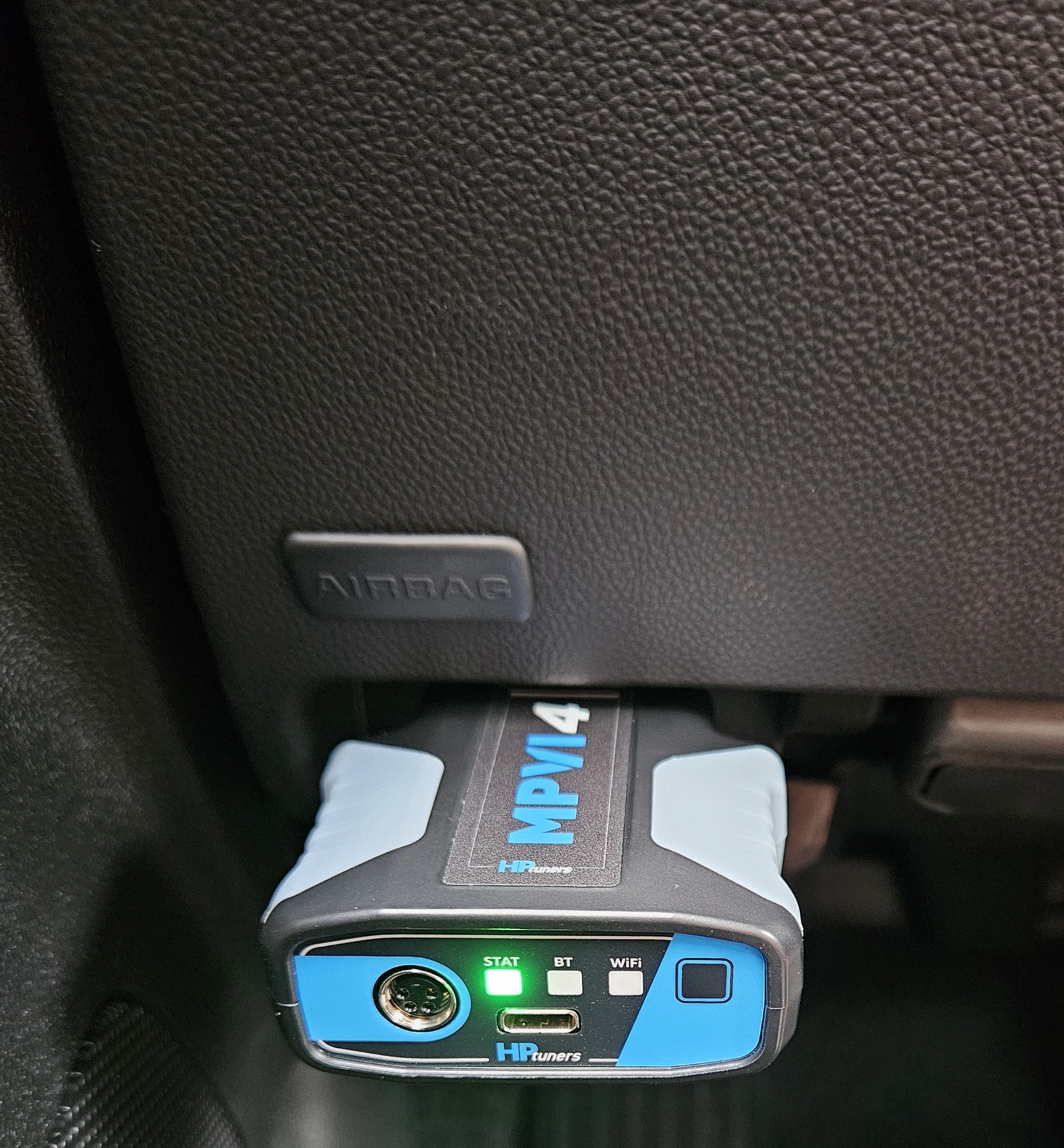

  5. To end your live session, click the standalone datalogging button again, The device will illuminate green indicating it has finished.
