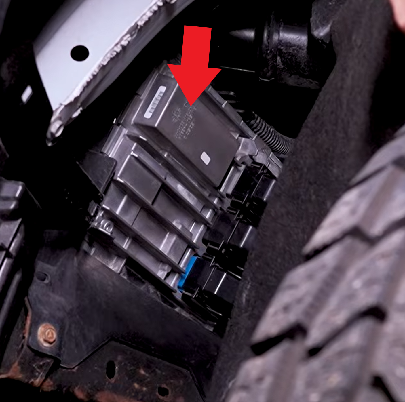

B. Locate the E90 ECM in your vehicle. It will be mounted behind the driver's side wheel well liner. You will need to remove some plastic push-tabs and screws to pull the wheel liner back enough to reach the ECM.
C. Disconnect all 3 ECM harness connectors from the ECM.
D. Connect the supplied E90 Upgrade Harness to the Blue J1 connector and Grey J3 connectors of the ECM. The middle Black connector will be left disconnected.

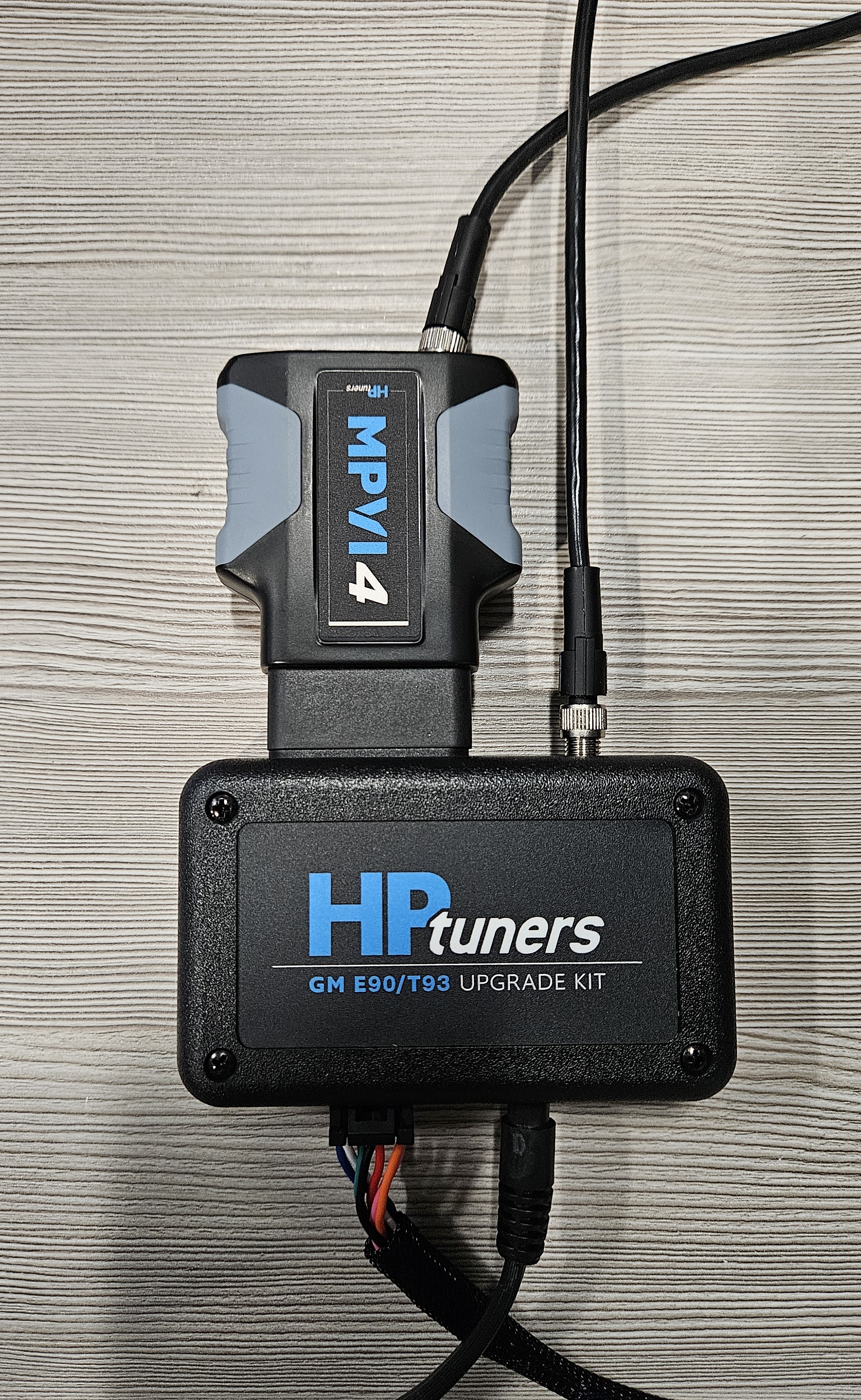

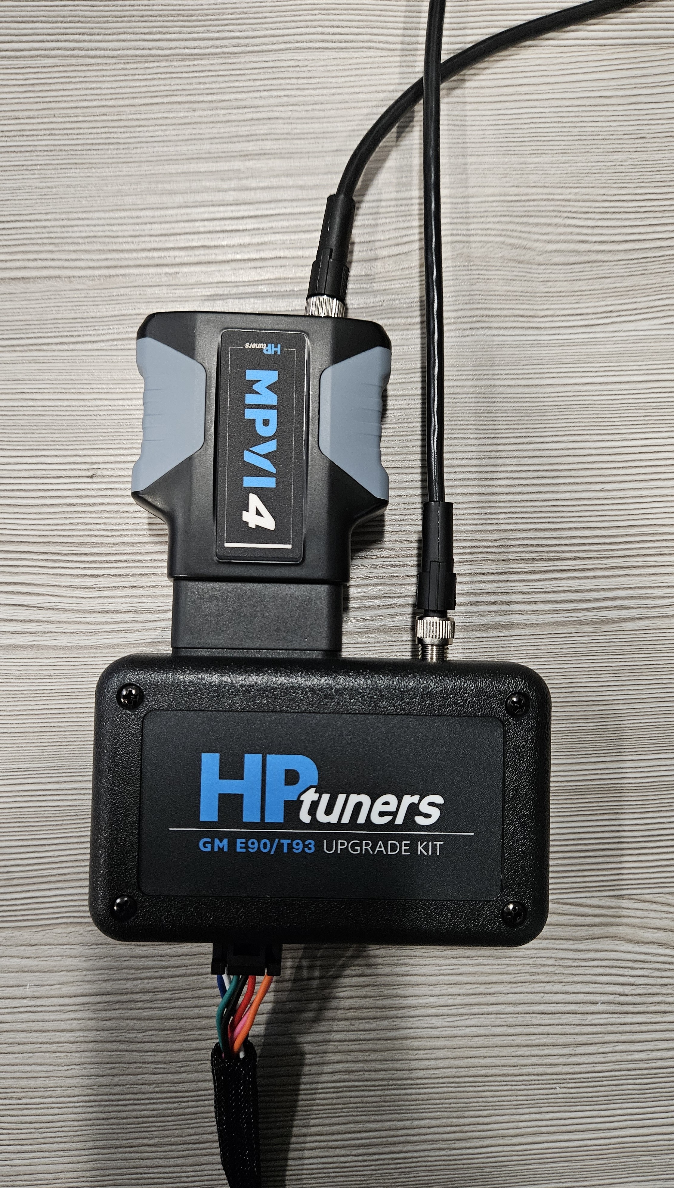

E. Connect the HPTNet cable (cable with M8 connectors) to the MPVI and the Upgrade Box.
F. Plug your MPVI into the OBDII port on the Upgrade Box.
G. Plug the 12-pin connector on the E90 Upgrade Harness into the Upgrade Box.

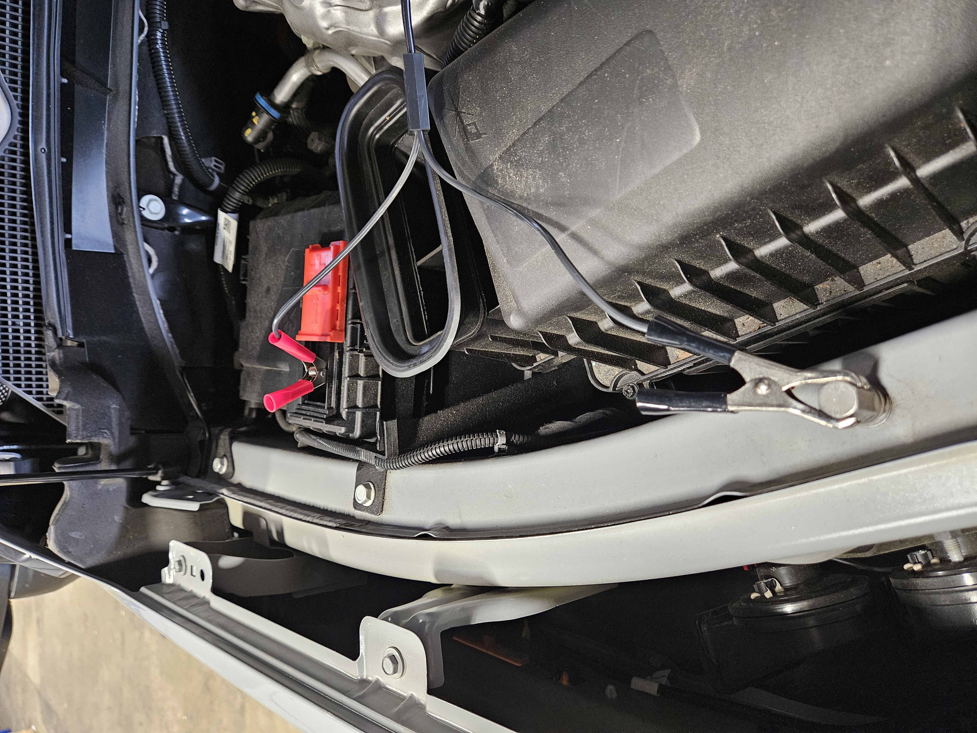

H. Plug the 2.1mm barrel plug of the supplied power cable (with alligator clips) into the Upgrade Box.
I. Connect the alligator clips of the power cable to the vehicle's battery. Be sure to connect the Red alligator clip to the POSITIVE (+) battery terminal, and the Black alligator clip to the NEGATIVE (-) battery terminal.

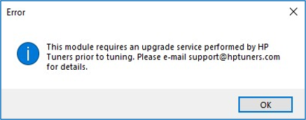

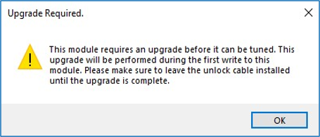

B. Read the vehicle by going to the Flash menu and selecting Read Vehicle. If the cable is installed and the module has not been upgraded yet, you will receive a window with the following message:
- If you do not receive this message and you are not provided with a stock file to tune the vehicle, check the cable installation. If you do not receive this message and are provided with a stock file to tune the vehicle, then the ECM is already upgraded. Please uninstall the cable and tune the vehicle as normal.
- If the upgrade cable is not installed, you will receive the following window and the read will exit.

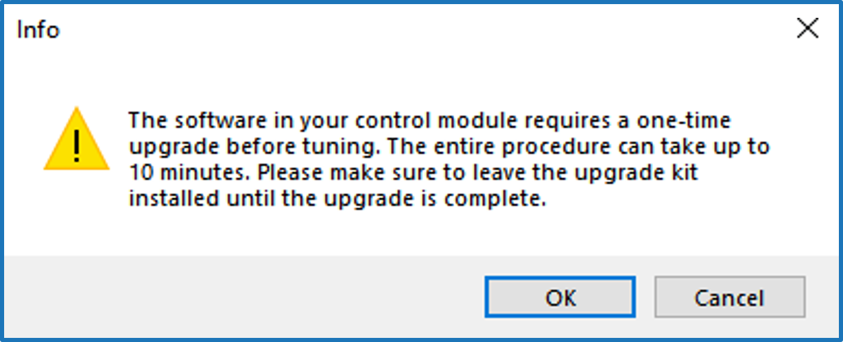

B. Once the write begins, VCM Editor will perform the upgrade to the ECM first. This process may take up to 10 minutes. If the cable is installed, you will receive a window with the following message before the upgrade begins:

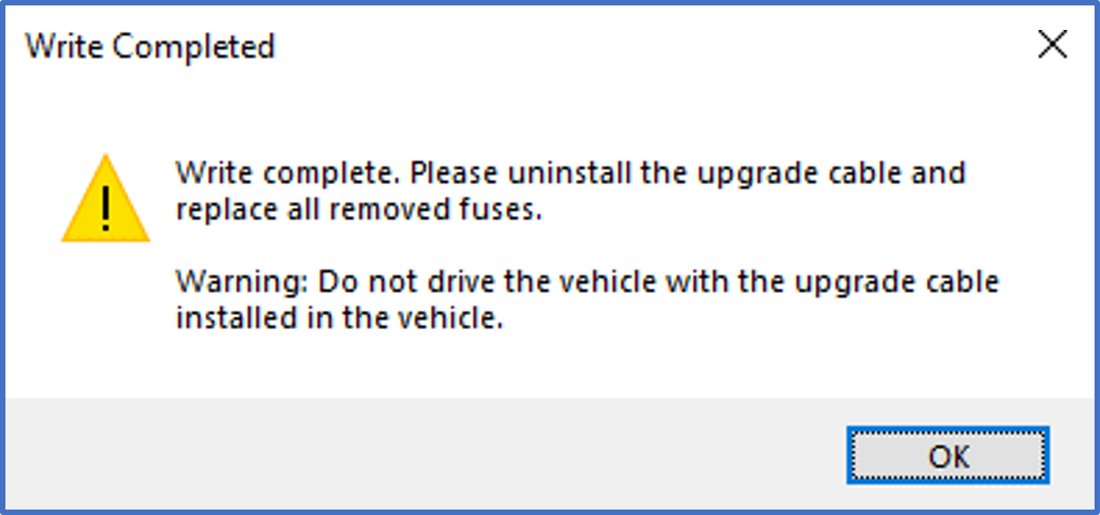

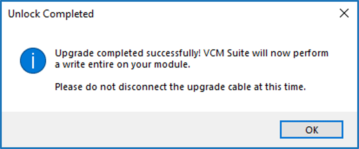

C. Once the upgrade is complete, you will receive a window with the following message:
D: After clicking OK on the previous window, VCM Editor will now perform a “Write Entire” of the currently loaded tune file to the ECM. Once this write finishes, you will receive the message:

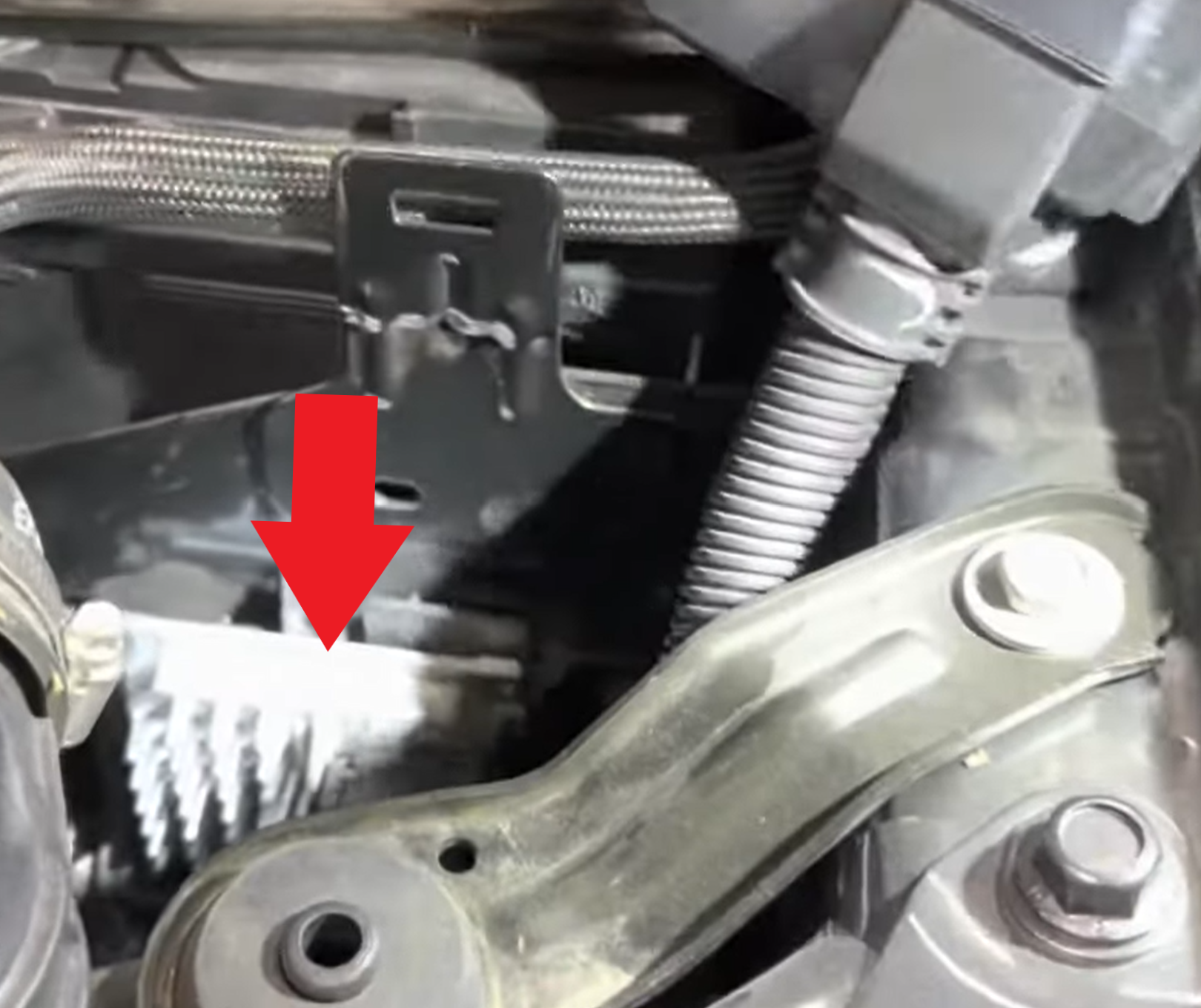

B. Locate the T93 TCM in your vehicle. On the LM2 (3.0L turbo diesel) engines and most all GM T93's the TCM will be mounted behind the driver's side wheel well liner. You will need to remove some plastic push-tabs and screws to pull the wheel liner back enough to reach the TCM.
On GM's L5P engines (6.6L Duramax) the T93 TCM sits below the fuse box in the driver side engine bay.
C. Once you have located the T93 TCM behind the driver's side wheel well liner, remove the 3 bolts that are holding the TCM mounting bracket to the vehicle. Pull the mounting bracket towards you and this will provide access to the T93 TCM on the other side.
D. Disconnect the factory TCM harness connector from the T93 TCM.

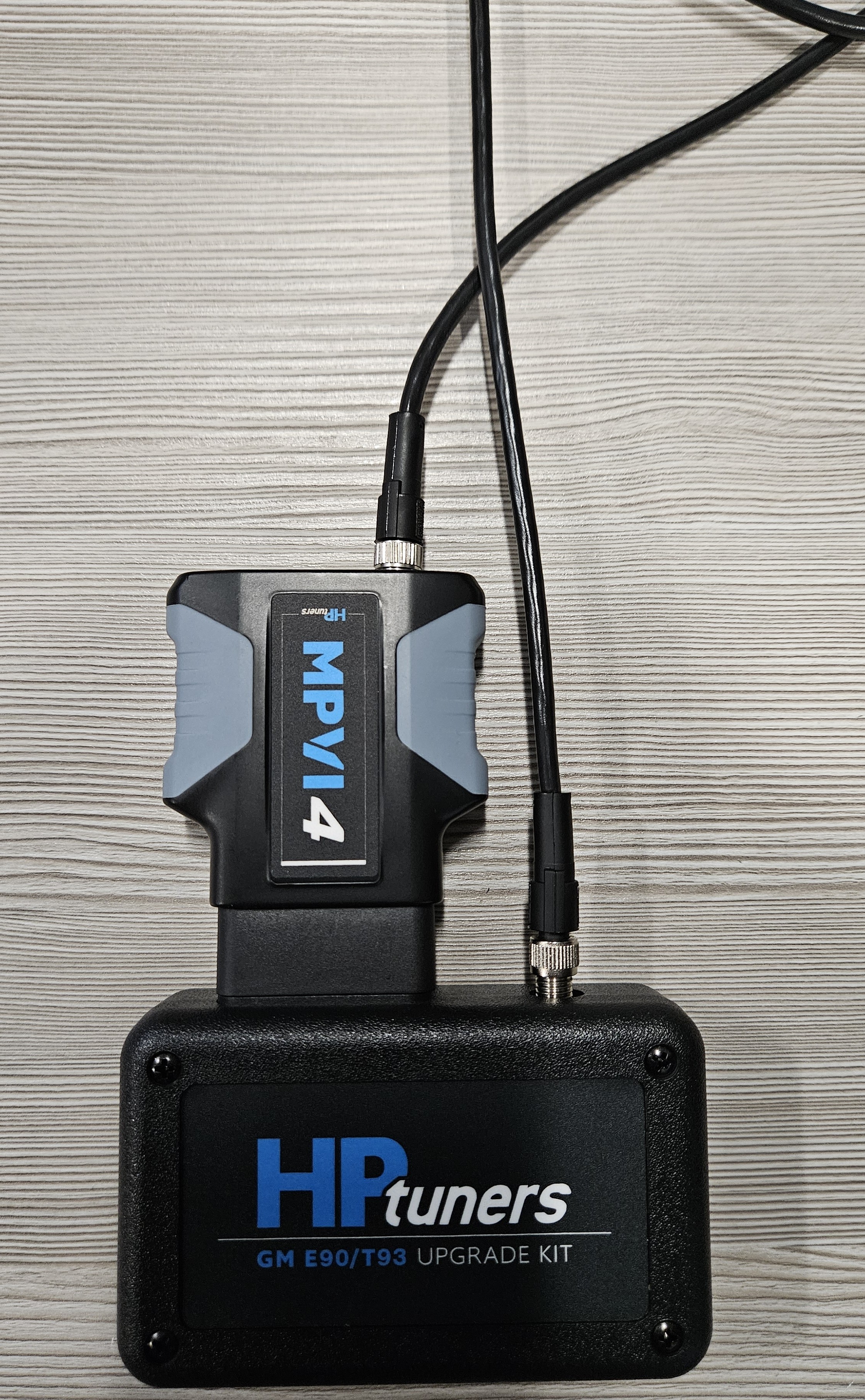

F. Connect the HPTNet cable (cable with M8 connectors) to the MPVI and the Upgrade Box.
G. Plug your MPVI into the OBDII port on the Upgrade Box.
H. Plug the 12-pin connector on the T93 Upgrade Harness into the Upgrade Box.
