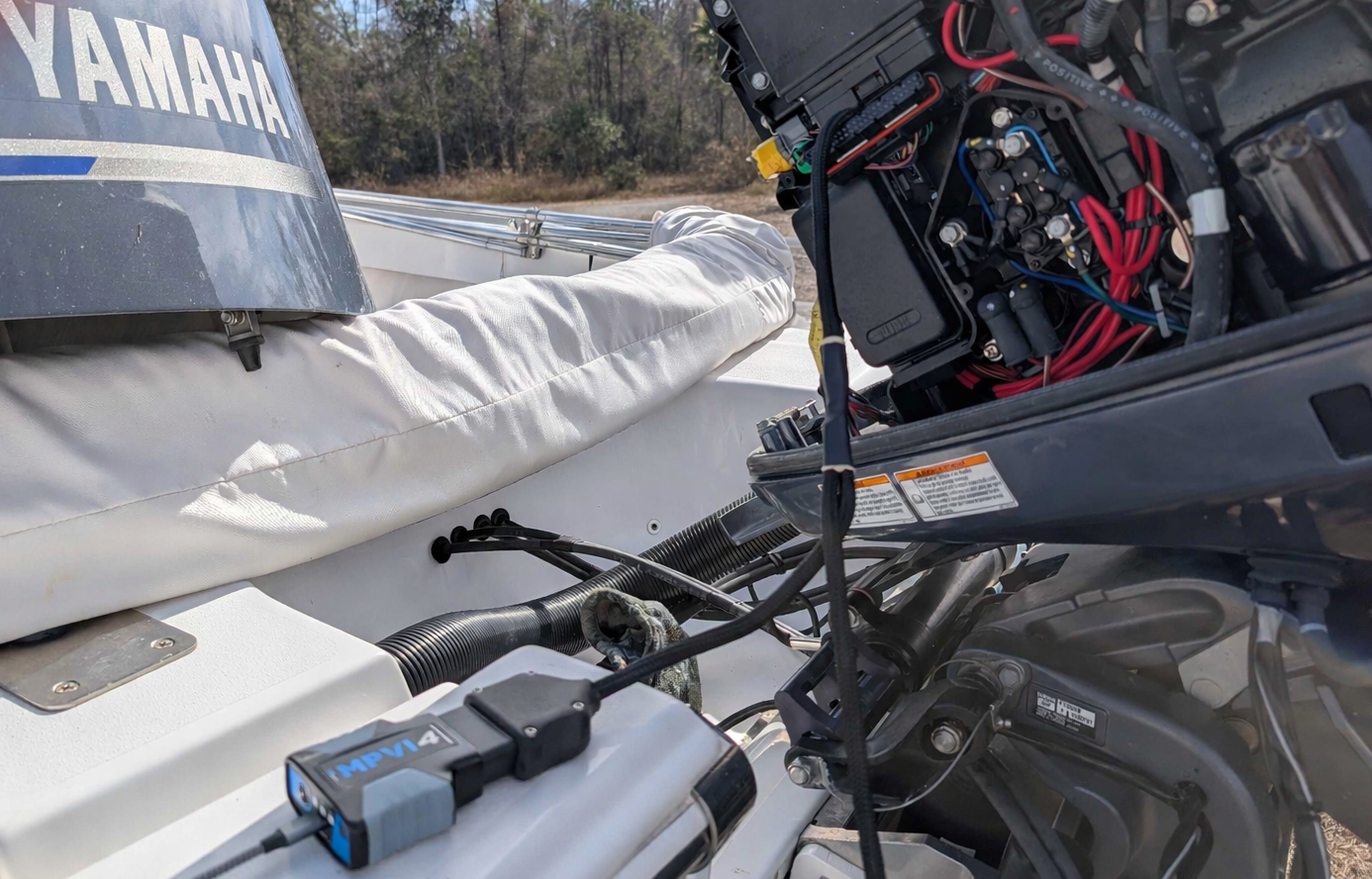

  3. Connect your MPVI4 to the OBDII adapter cable.
    • The above image is referencing the Yamaha outboard 44 pin connector, style 2.

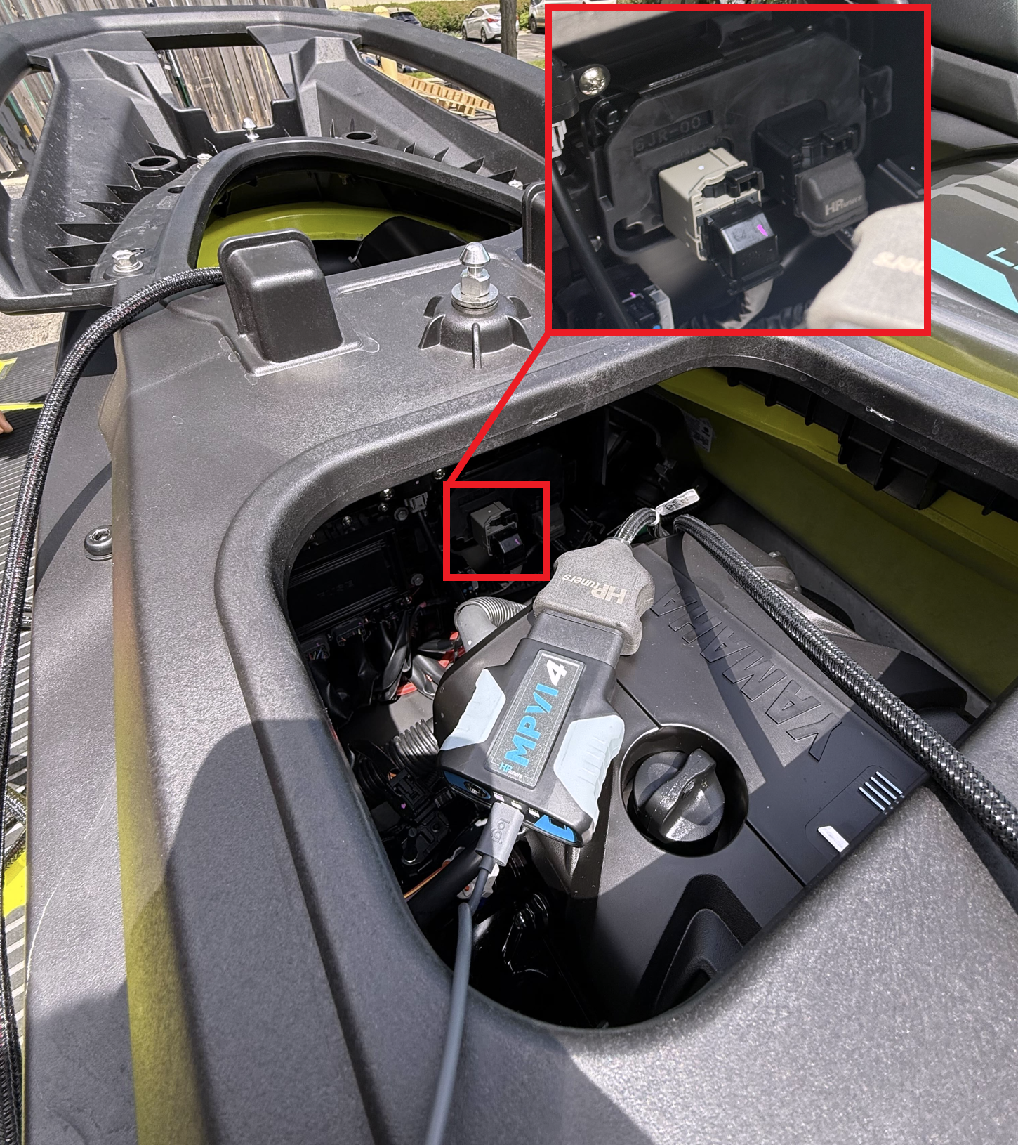

    Danger
    Disconnecting the white connector, or leaving it disconnected, before or during the flash process will generate a DTC. This DTC must be manually cleared using the Yamaha 3-pin diagnostic cable before operating the vehicle (see image below).
