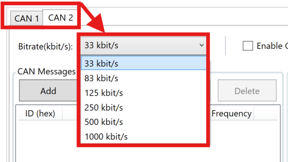

    • CORE communicates via CAN so setting up requires connecting the TurboLamik to one of the designated CAN ports, with the matching bitrate on the TurboLamik side.

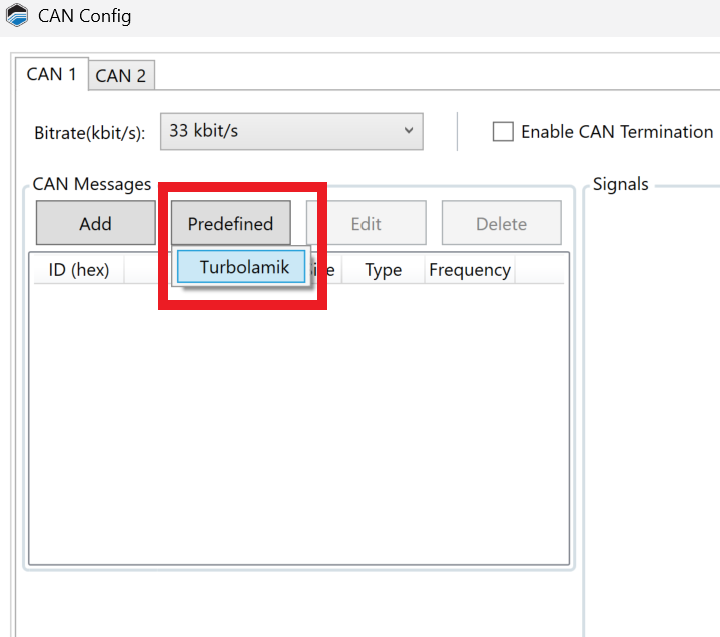

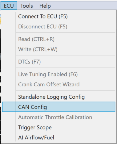

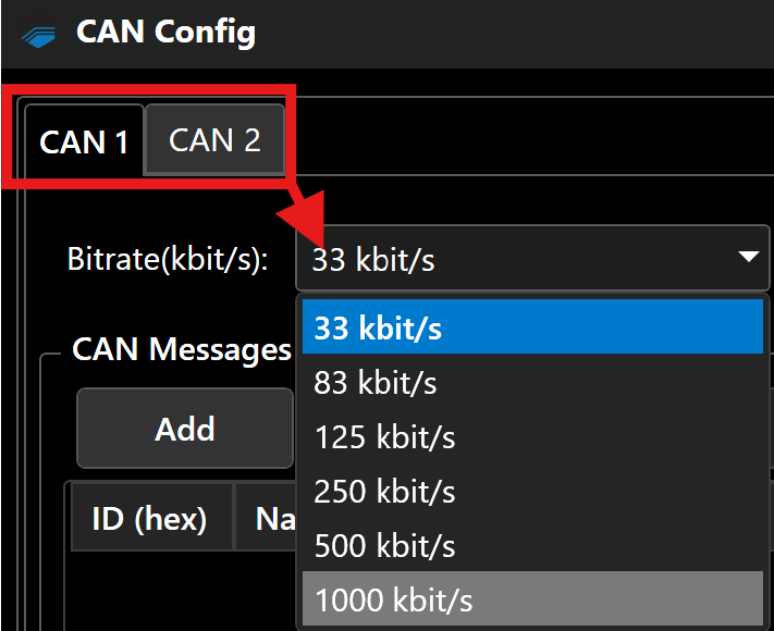

  4. In the menu bar click ECU > CAN Config.

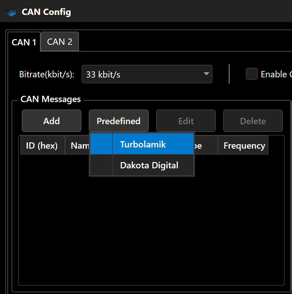

  5. In the CAN Config window select the CAN port that is physically connected to the TurboLamik TCU (CAN 1 or CAN 2) and ensure the bitrate matches the bitrate on the TurboLamik TCU.

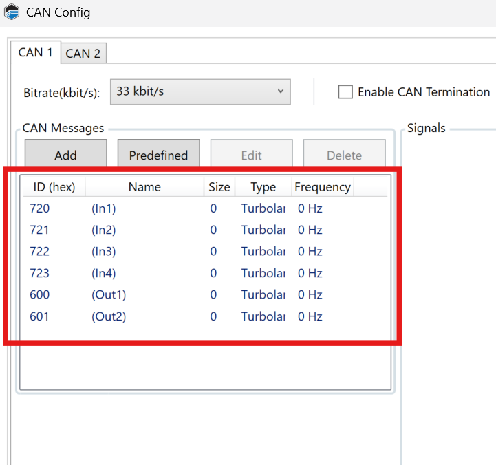

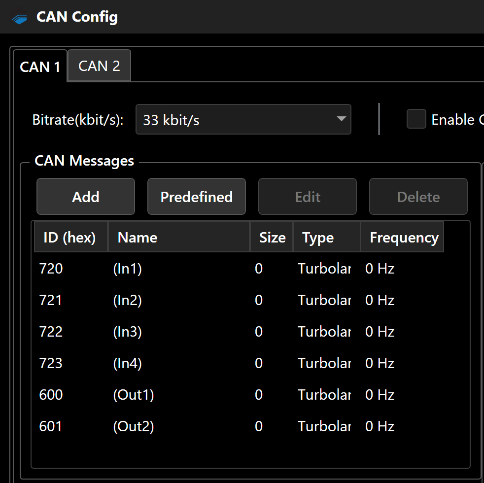

  6. Click Predefined > Turbolamik.
    Caution
    These are grouped messages, if one gets deleted the entire group of messages will be deleted.
  7. Click Ok.

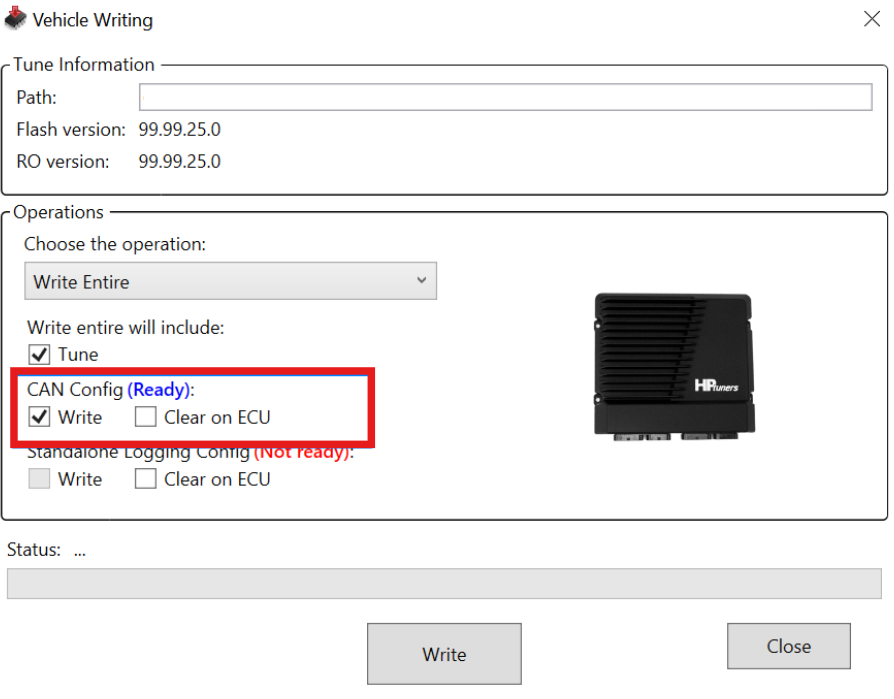

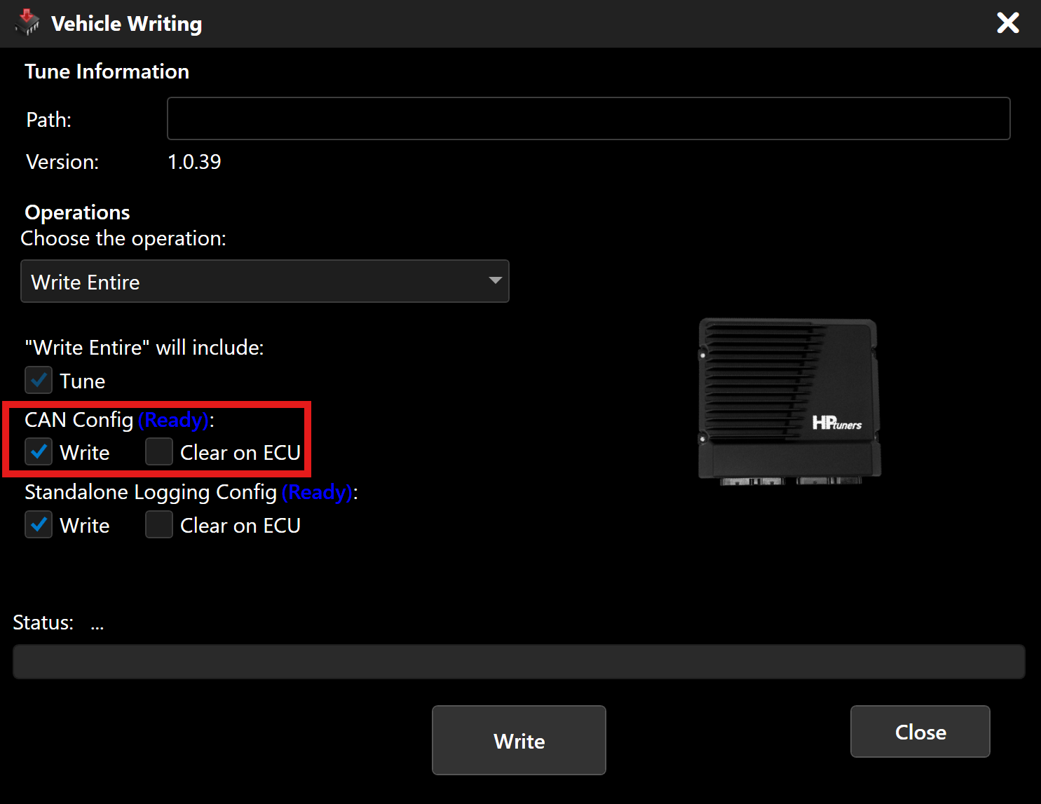

  8. Click icon to write the CAN config changes to CORE.
    • Ensure "CAN Config (Ready):" Write check box is checked off (refer to image below).
  9. Click Write.

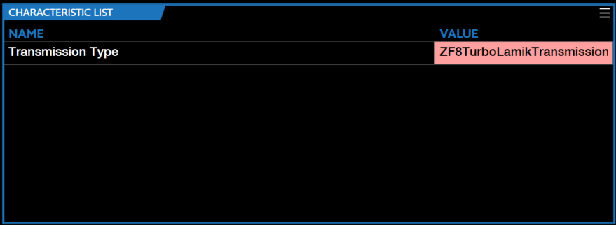

  4. Ensure to change the characteristic Transmission Type parameter to the ZF8TurboLamikTransmission value.

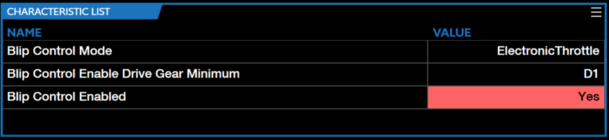

  5. Enable Blip Control, by selecting the below values for all of the below characteristics.
    • CORE Blip Control allows users to set a defined throttle position during transmission downshifts. This feature is exclusively applicable to the ZF8 transmission.

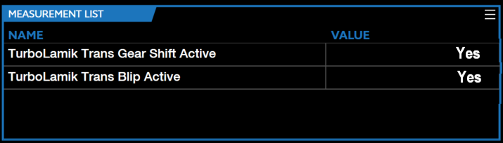

  6. Activate all of the below characteristics with the below values.

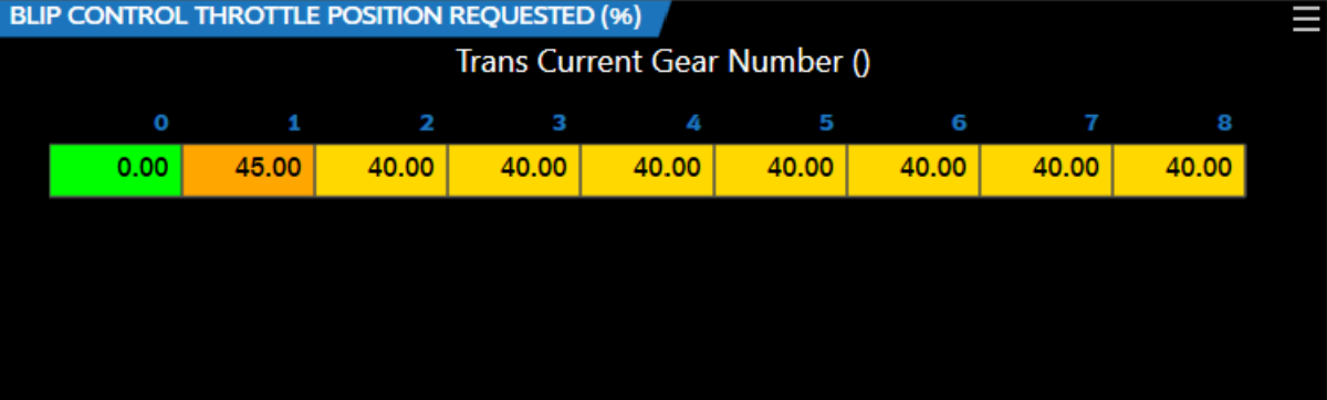

  7. Tune blip behavior with the below characteristics.
    a. "BLIP CONTROL THROTTLE POSITION REQUESTED (%)"
    • This table defines the throttle position during a blip.

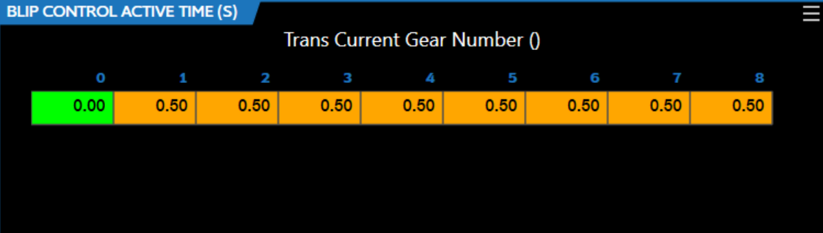

    b. "BLIP CONTROL ACTIVE TIME (S)"

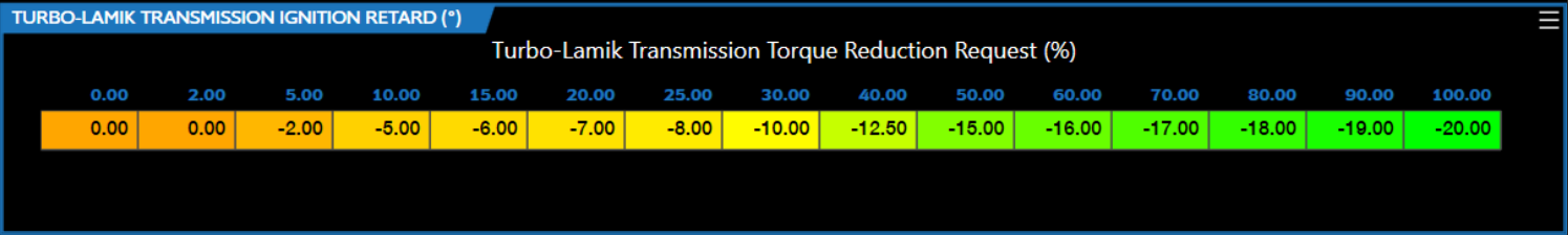

  8. Utilize the "TURBO-LAMIK TRANSMISSION IGNITION RETARD (°)" characteristic to retard the ignition angle (spark) to enable smooth transmission shifts.
    • TurboLamik provides the torque reduction (%) to CORE, which then uses this input to retard the ignition timing based on the below table.
