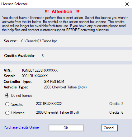

The prompt the software displays looks like this:
The cost of each license option is listed in credits. Credits are the currency HP Tuners uses for license transactions. See Credits for more information.
Choose the desired option and click the Ok button. The appropriate amount of credits will be deducted from the credits on your MPVI.
