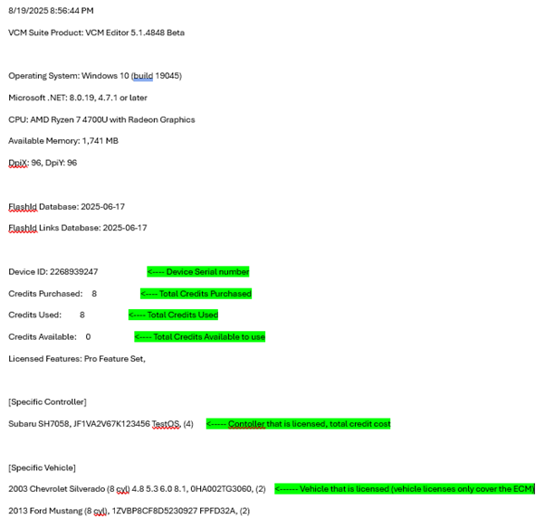

This triggers the software to poll both your computer and the vehicle. It may take 5 - 20 seconds to complete.
Step 4. Review the Infolog for credit usage and availability (refer to image below).
Ensure to have the device in question connected when pulling the Infolog.
