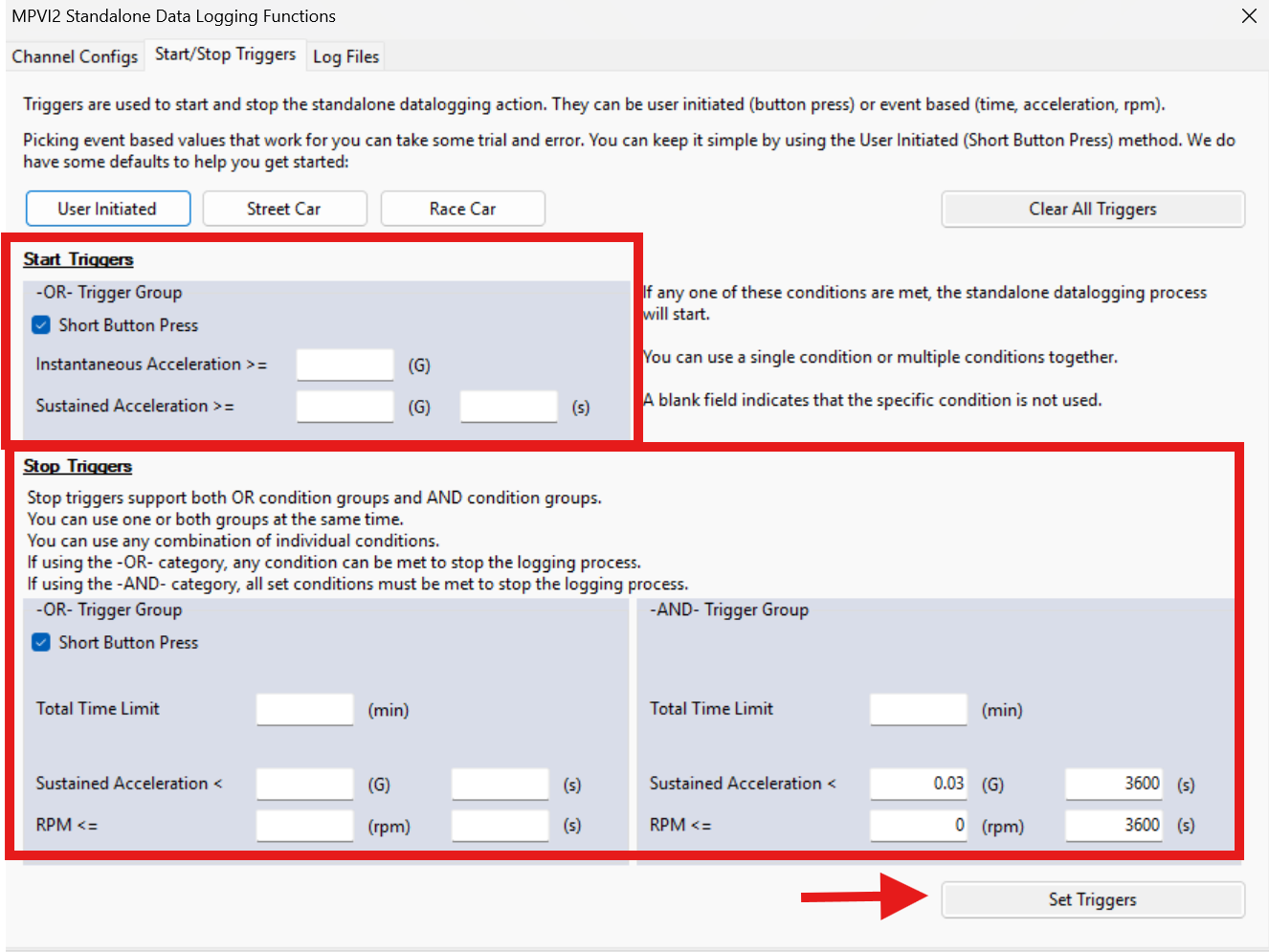

Click Vehicle > MPVI2 Data Logging, when the MPVI2 Standalone Data Logging Functions window appears click the Start/Stop Triggers tab.

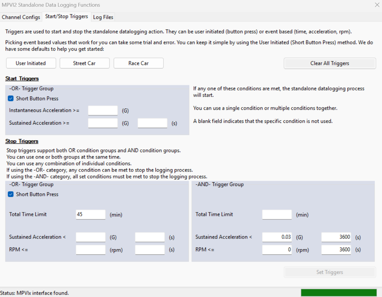

Adjust your start and stop triggers that will enable your standalone data logging, once adjusted to your preferred settings click Set Triggers.
- Standalone Data Logging will only begin to collect data when the USB and bluetooth are disconnected and not being used by VCM Suite or TrackAddict.
- The MPVI3 must be connected via your vehicles OBD port and power must be detected as well.
- Three buttons are available: User Initiated, Street Car, and Race Car. Selecting one auto-populates relevant fields to help you get started.
- Under Start Triggers, you can enter either an instantaneous or sustained acceleration value. Instantaneous acceleration starts logging as soon as the threshold is reached. Sustained acceleration requires a duration for which the value must be exceeded (e.g., 0.05 G for 1 second).
