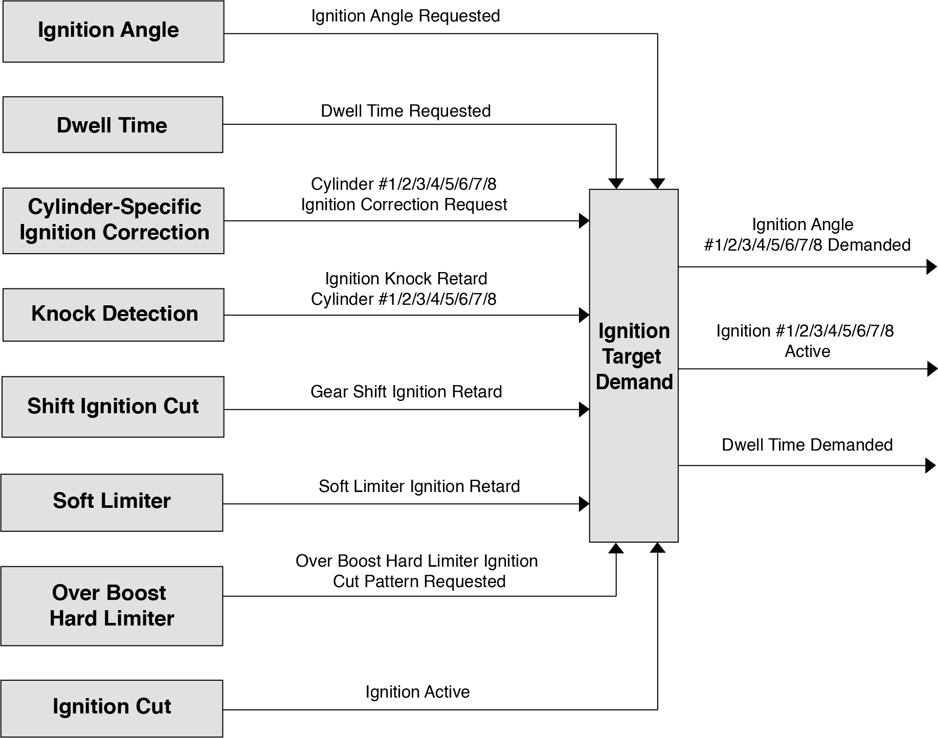

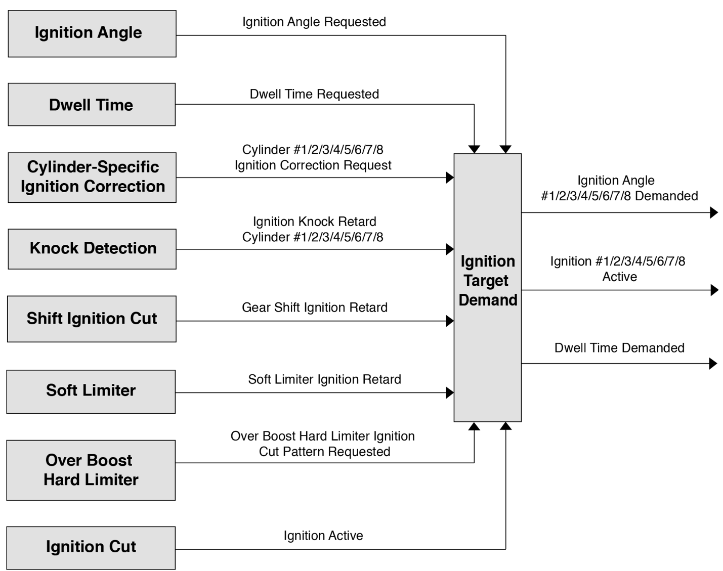

The final timing demands sent to the spark plugs are controlled by the Ignition Target Demand Module. To perform this task, Ignition Target Demand requires input from many other modules.
