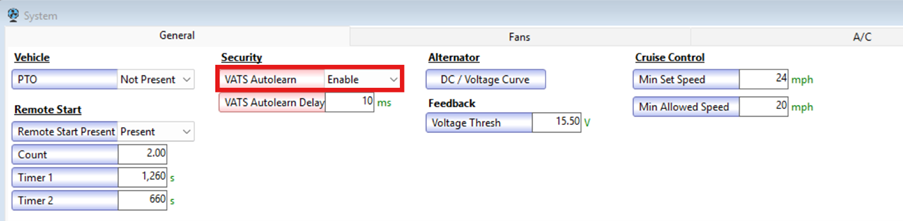

Step 3. Click on the "System" tab, under "General" > "Security", locate the "VATS Autolearn" tab.
Step 4. Set to "Enable" (refer to image below).

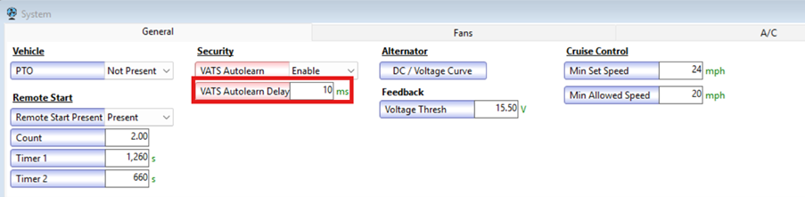

Step 5. Set "VATS Autolearn Delay" to 10 ms (refer to image below).
