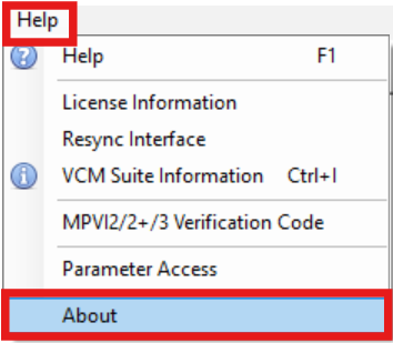

Step 2. Navigate to the Top Menu Bar and click "Help > About".

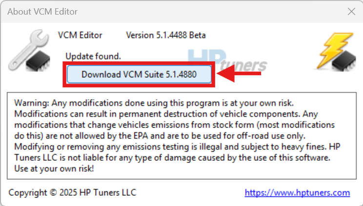

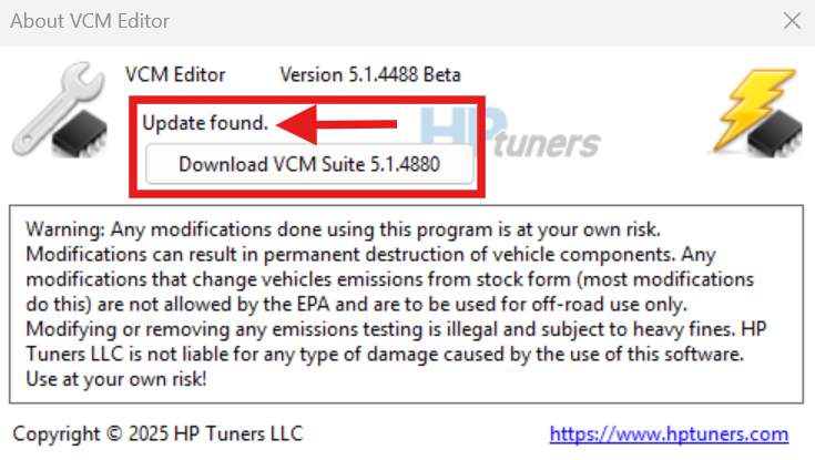

Step 3. A software window will appear. If a new software update is found it will appear under the "Update found." section of the window (see below).
Step 4. Click on the latest software update (see below).

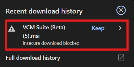

Step 5. Double click the new software update in your browser's recent download history (see below).

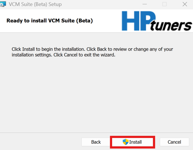

Step 7. Click "Install" (see below).

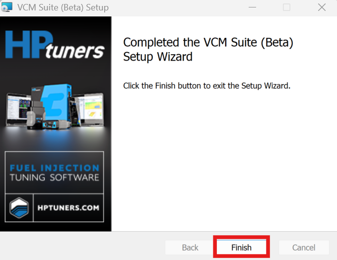

Step 8. Click "Finish" (see below).
