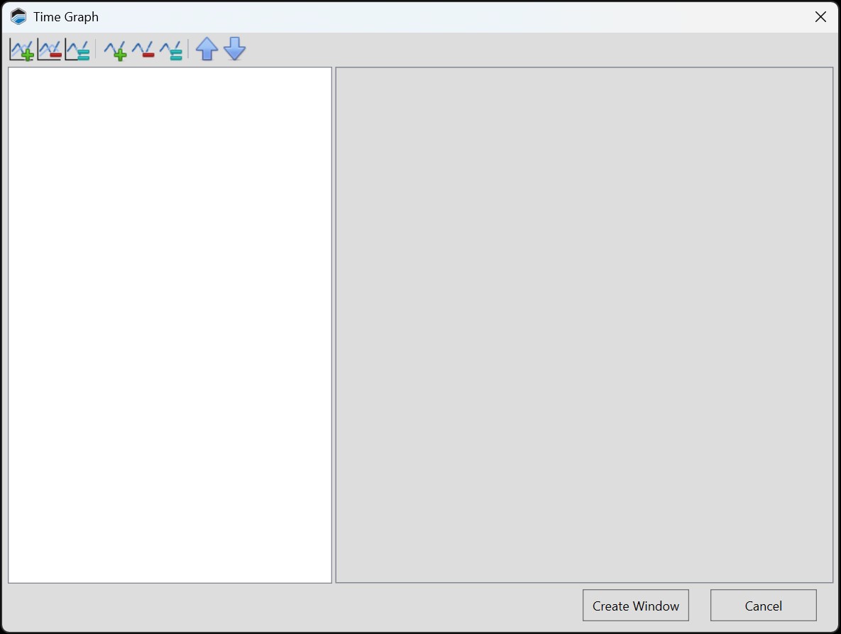

To add a time graph:
  1. In the menu bar, select Layout > Add Control > Add Measurement > Add Time Graph. The below window will appear, create your desired group (s) with which ever measurements you desire, utilize the below Adding a Group & Adding a Signal (Measurement) to a Group instructions to do so.
  2. When configuration is complete, Click Create Window.

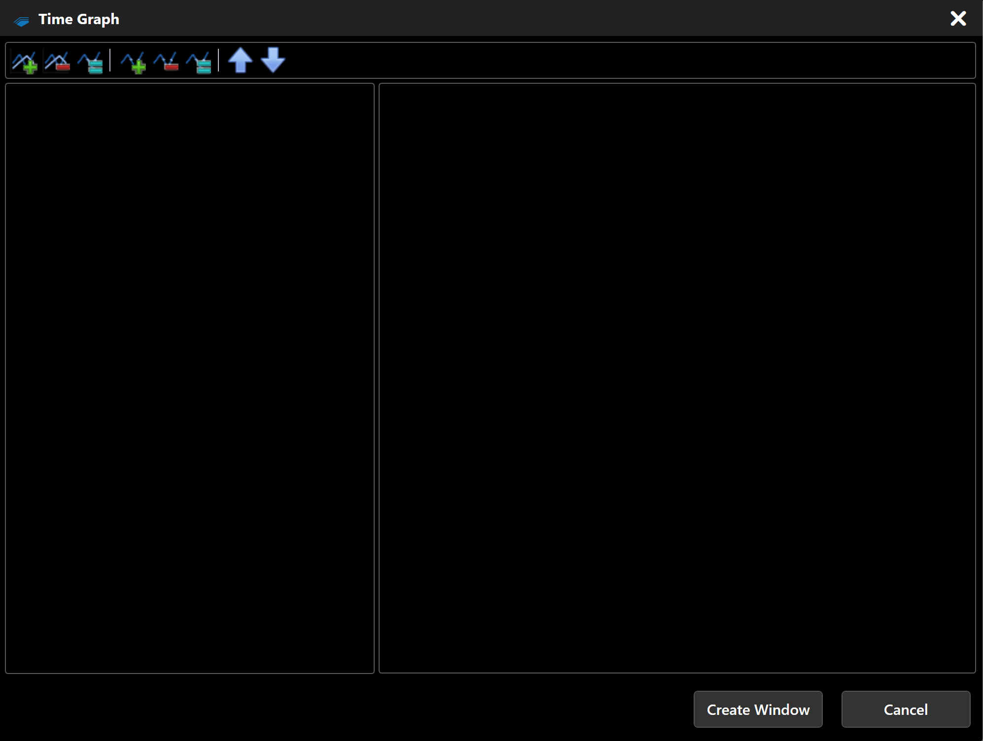

Toolbar
Icon Description
Add a new (empty) chart group. To complete group setup, add the signals (series) that would be included in the group.
Delete the chart group selected in the left column.
Duplicate the group selected in the left column.
Add a new signal (series) to the group selected in the column on the left. To complete signal setup, you must configure the signal's parameters.
Delete the signal (measurement) selected in the left column.
Duplicate the signal (measurement) selected in the column on the left.
Move the signal selected in the left column upwards in the list.
Move the signal selected in the left column downwards in the list.
