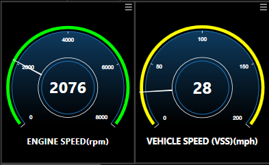

For round gauges, the following additional parameters can be configured:
| Parameter | Description |
| Divisions | How many numbers appear on the outside of the gauge? Both gauges above have five. |
| Factor | The raw value will be divided by this number to produce the numbers on the gauge face. For example, you could divide the numbers around the edge of the gauge on the left by 1000 to make them read 2, 4, 8, 10. |
| Arc Sweep | How far around the edge of the gauge (in degrees) does the numbering go? At 40 degrees, the gauge will look like a narrow slice of pie. At 260, it's almost the whole pie. Both of the gauges above use 260. |
