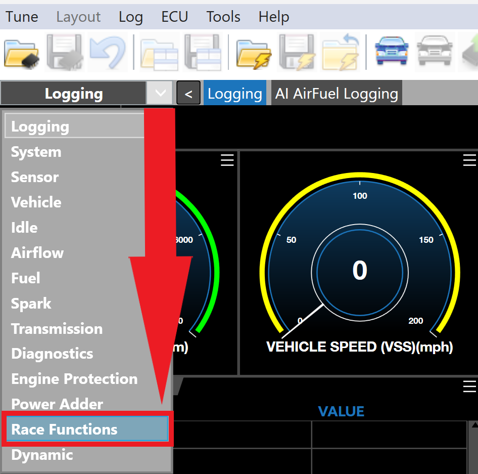

  2. Open VCM Live and click the drop down arrow in the group layout tab and select Race Functions.

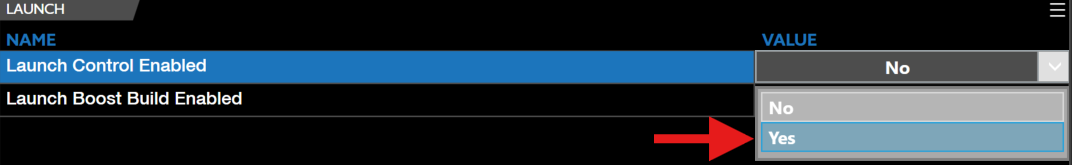

  4. Select the Launch Control Enabled characteristic parameter to Yes.

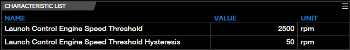

  8. Launch control's rev limiter is now active, Locate the below characteristics and calibrate each threshold to your application.
    When engine RPM reaches the defined thresholds, CORE applies fuel cut, spark cut, or a combination of both, to maintain the target RPM.

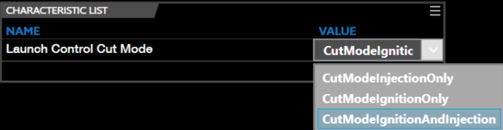

  9. Locate the Launch Control Cut Mode characteristic parameter and select from the following rev limiter strategies:
    • CutModeInjectionOnly = Fuel Cut
    • CutModeIgnitionOnly = Spark Cut
    • CutModeIgnitionAndInjection = Fuel + Spark Cut
