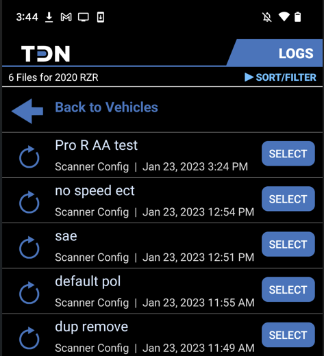

Select the vehicle for which you want to select a scanner configuration file. A list of log files available for the selected vehicle appears. Scanner configuration files will be labeled Scanner Config.
If a scanner configuration that your tuner has sent you is NOT listed here, tap the SYNC FILES button at the bottom of the page to update the list.
By default, the most recent scanner configuration file sent by your tuner will be selected. However, you can manually change which file is selected:
To deselect a scanner configuration file, tap on the currently-selected file and then tap DESELECT.
To select a different scanner configuration file, tap on the desired file and then tap SELECT.
