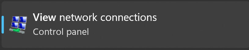

  2. In your search taskbar, search and select View network connections.

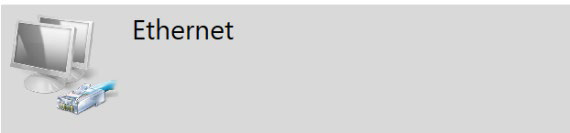

  3. Right click on the Ethernet cable you just plugged in.

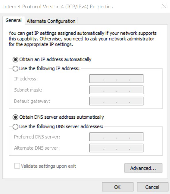

  4. Double click Internet Protocol Version 4 (TCP/IPV4).
  5. Ensure the information matches the settings below.

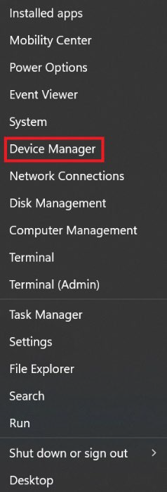

  1. Right click on the Windows Logo.
  2. Select Device Manager.

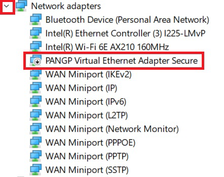

  3. Click on the drop-down arrow on the left-hand side of the “Network Adapter”, Then right click on the network adapter to reinstall.
    The exact name of the network adapter will vary from computer to computer.

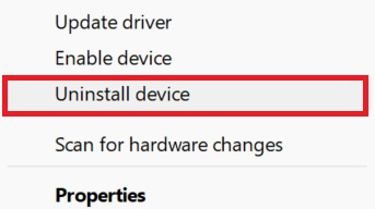

  4. Click Uninstall device.
    If a checkbox appears to also delete the driver software, leave this box UNCHECKED.
  5. Select OK.
  6. Restart your computer. The adapter will be reinstalled on startup and the adapter will be reset.
