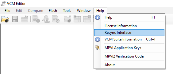

  2. Open VCM Editor.

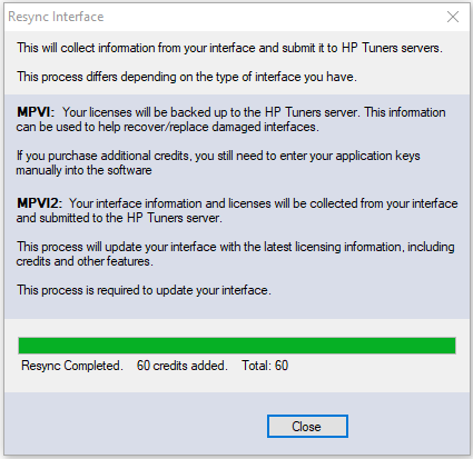

  3. From the Help menu, select Resync Interface.
  4. If the Sync was successful, the progress bar will indicate that the operation is complete.
