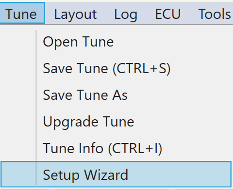

  3. Once all DTC’s and mechanical issues are resolved, open the Setup Wizard by selecting Tune > Setup Wizard in VCM Live's menu bar.

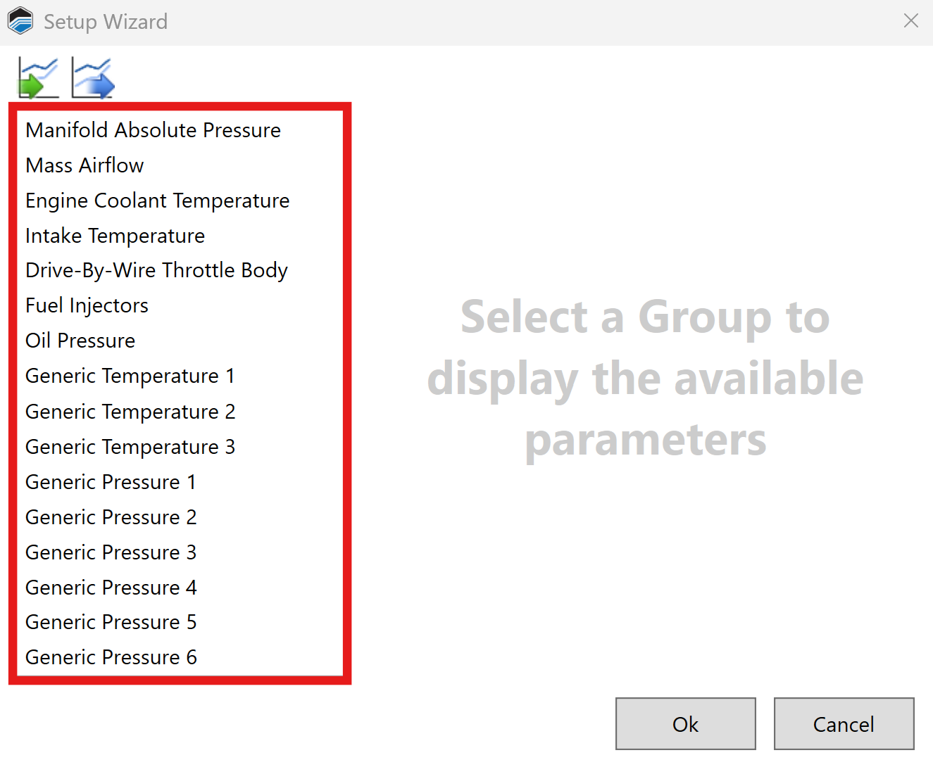

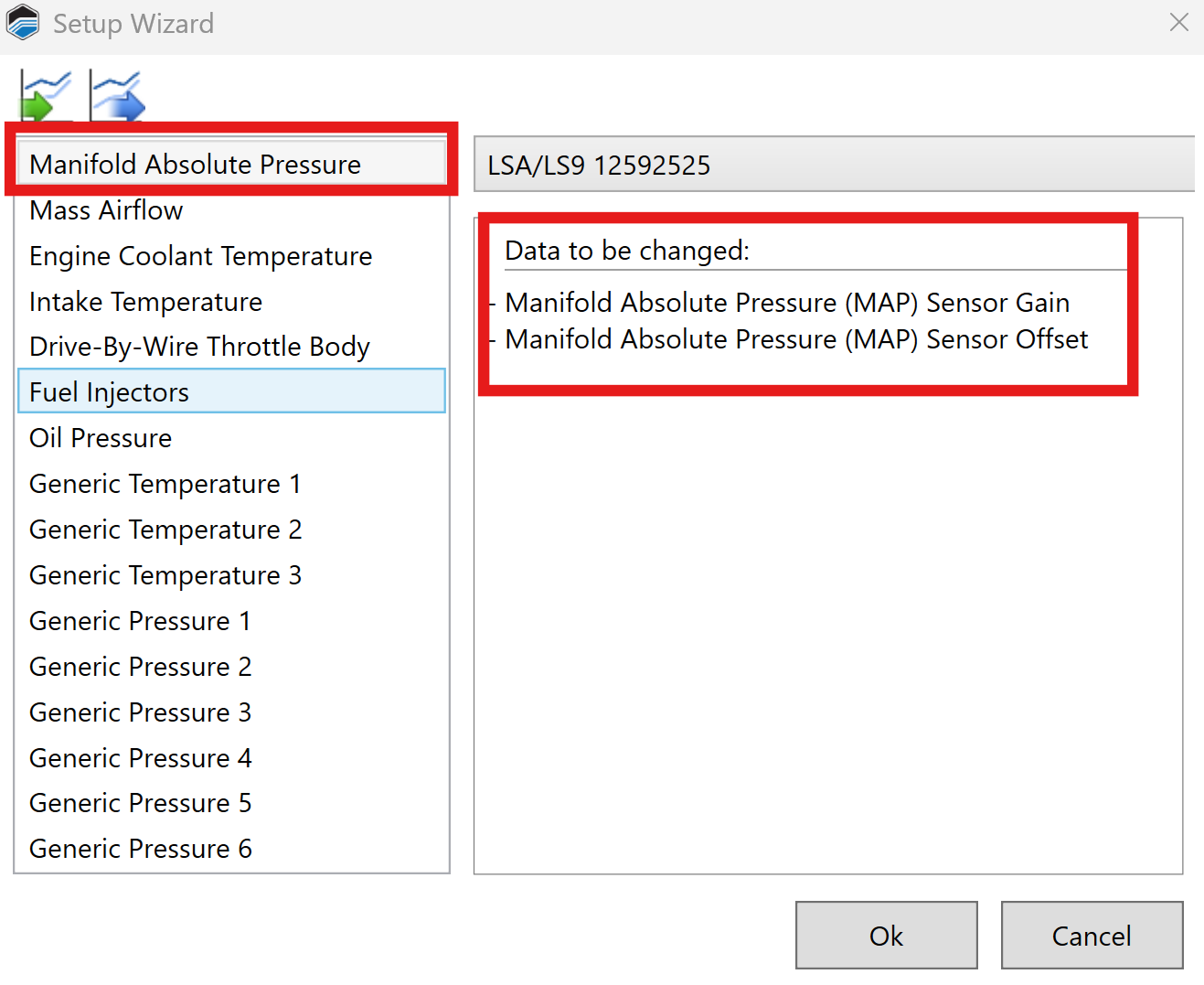

  4. Select each of the below applicable sensors and ensure to select the corresponding sensor part number being used for your specific setup.
  5. After each sensor part number is selected, a list of parameters will appear.
  6. Ensure these parameters are reporting a working value within VCM live by adding Measurement & Characteristic lists.
