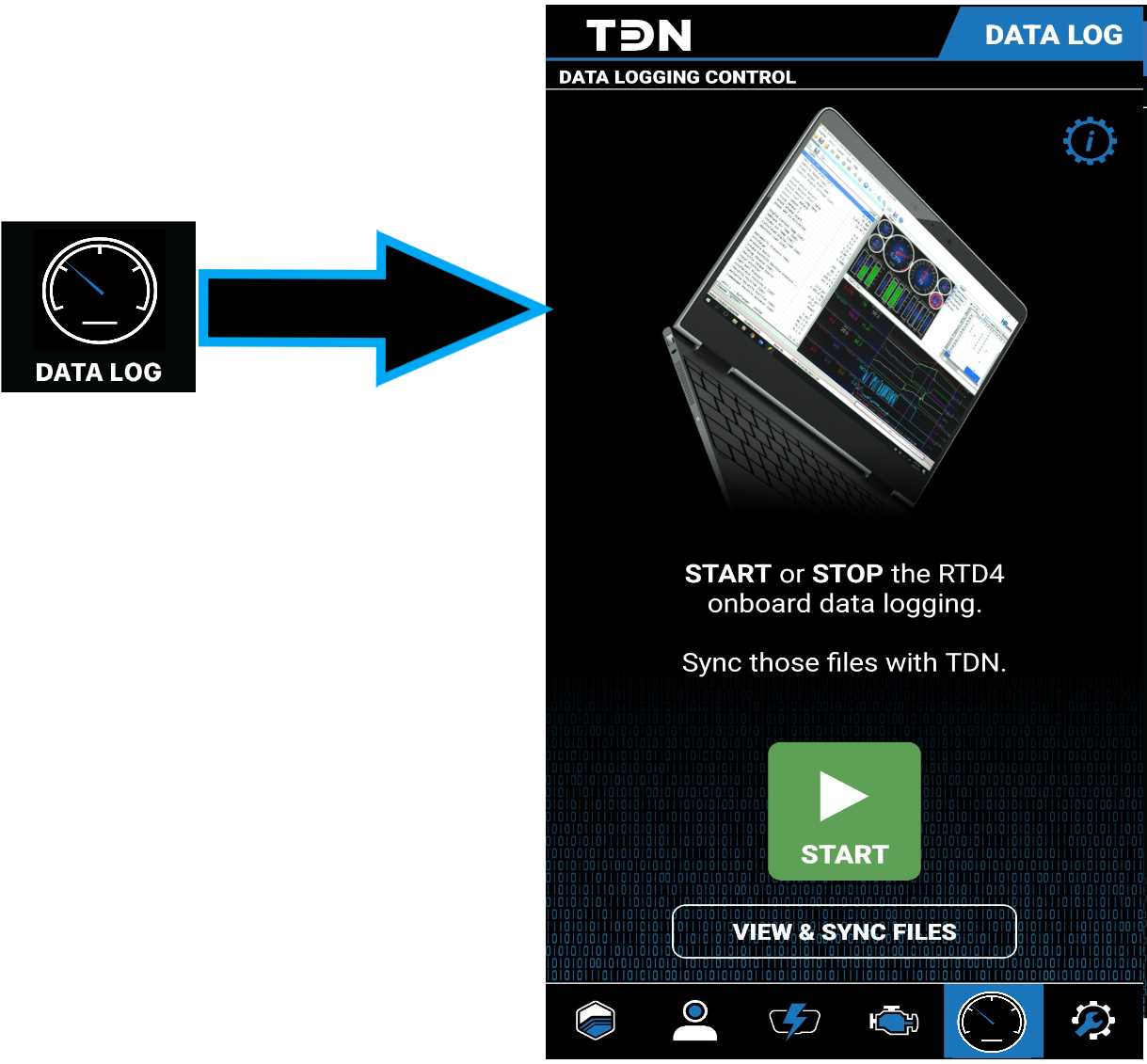

Generating a Data Log🔗
  1. Tap the Data Log button on the navigation bar. The Data Logging Control screen appears.

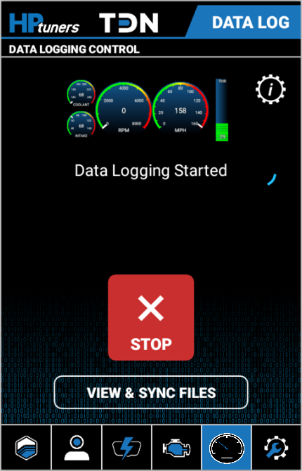

  5. Tap the START button to begin the session. Pay attention to the status displayed. There is a delay before logging actually starts.

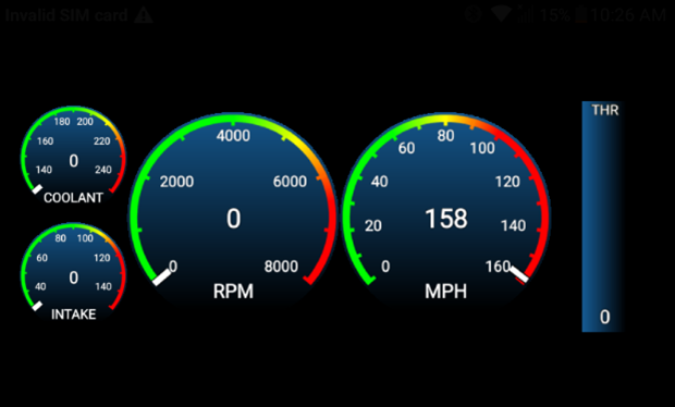

  6. Once logging starts, a screen with gauges is displayed, allowing you to monitor your vehicle’s data in real time. The screen can be displayed in either portrait view or landscape view.

  8. When you have enough data, end the session by doing one of the following:
    • Tap the STOP button.
    • Wait until the time selected earlier is reached.
