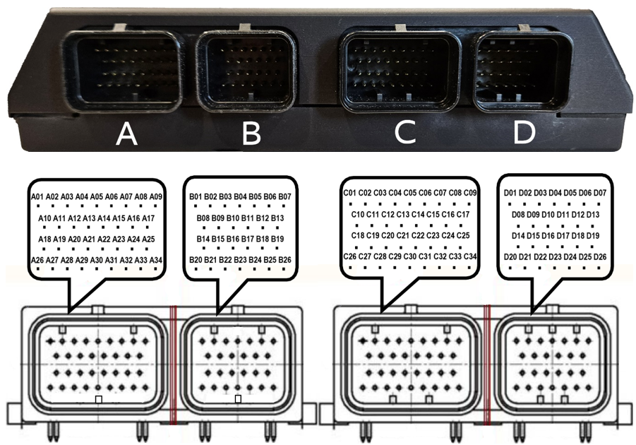

CORE Connectors🔗
CORE has four connectors on the bottom end of the ECU. Each connector head has 34 or 26 contacts with four rows, combined 120 contacts total with all four connectors.
