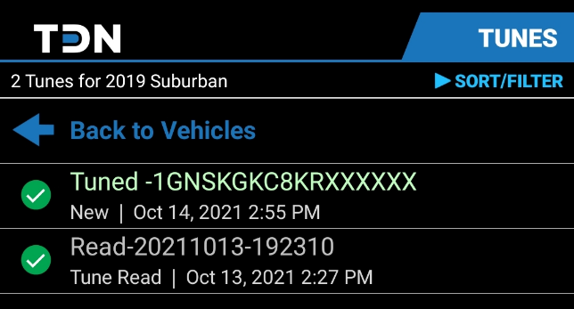

  3. Tap the vehicle to which you want to apply a tune. The list of tuning files for the selected vehicle appears.
    A1 Image

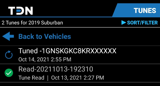

  4. When your tuner sends you a new tune file, it should automatically appear in the list. If you don’t see it here, or if it doesn’t have a green check next to it, click the SYNC FILES button near the bottom of the screen to retrieve the latest files.

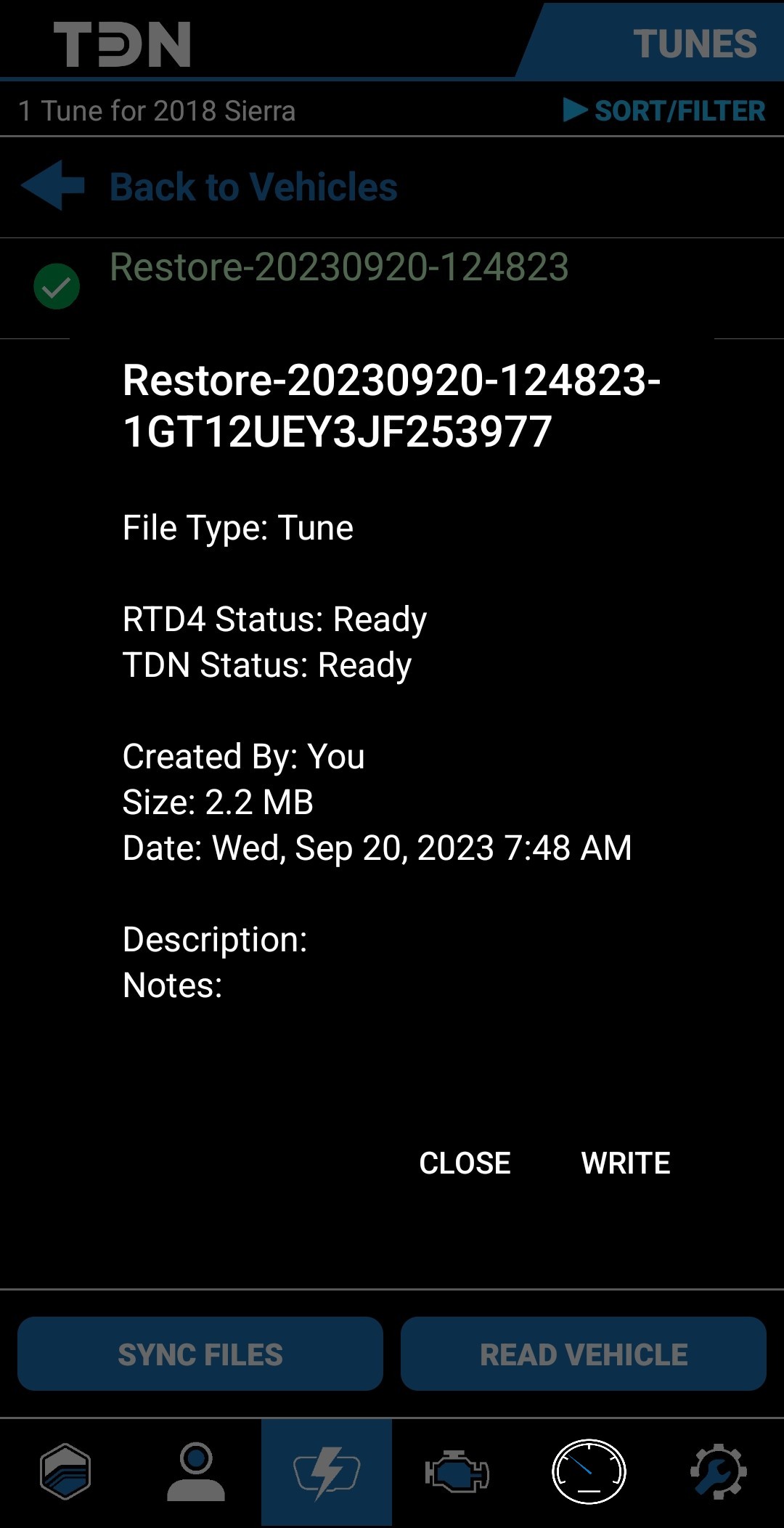

  5. Tap the tune file that you want to apply to the vehicle. A popup that includes information about the selected file appears.
    • A tune file that you have just read from the vehicle will have a name that starts with "Read-". Files with this name can't be flashed back to your vehicle. Once the file has been successfully transmitted to the TDN server, the name will be changed to begin with "Restore-". Files named this way can be flashed if you wish to restore the vehicle to the tune contained in that read.
  6. Tap WRITE VEHICLE.

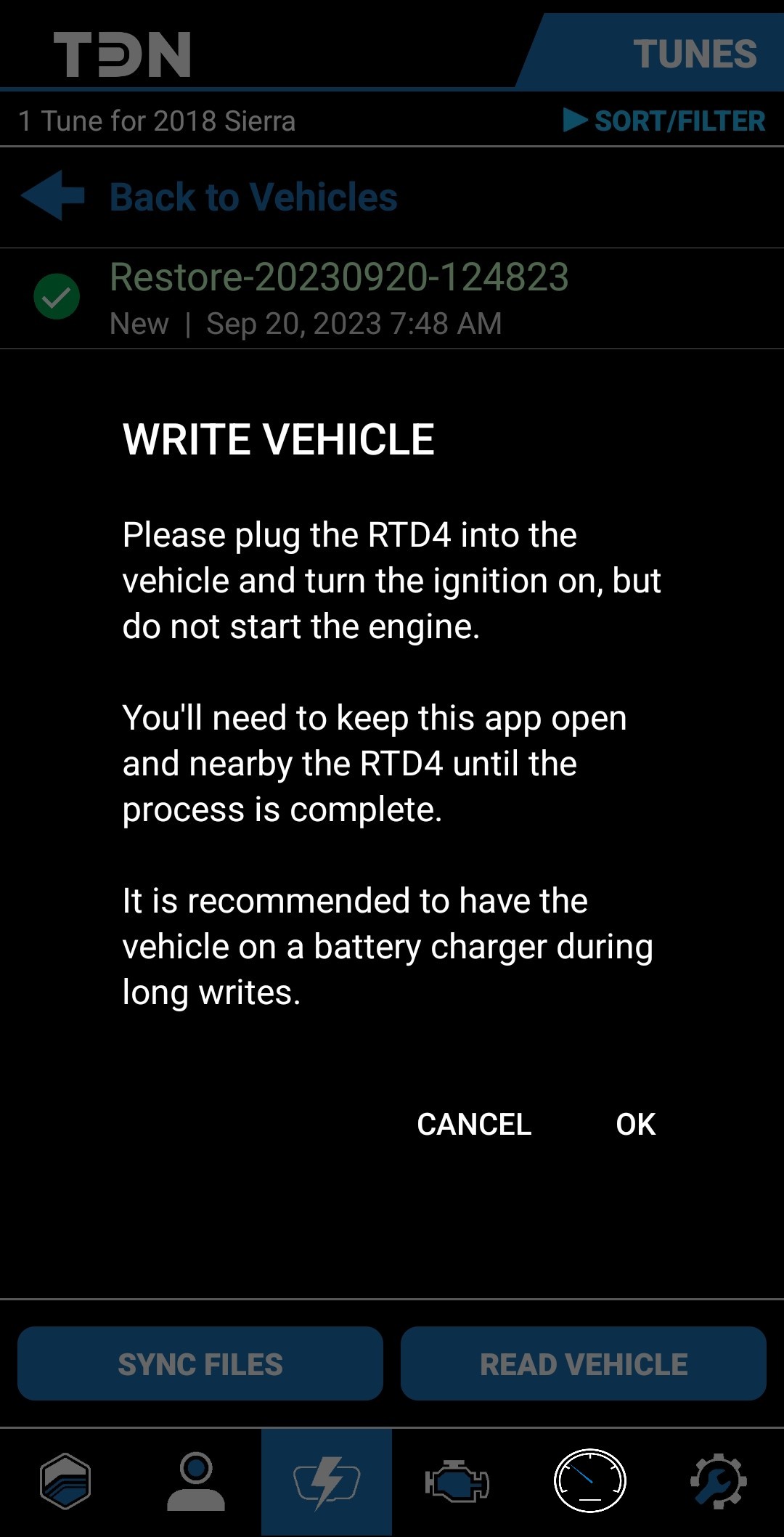

  7. A second popup appears. It prompts you to connect your interface device to the vehicle and turn the ignition to the on position (but do not start the engine). Do so now.

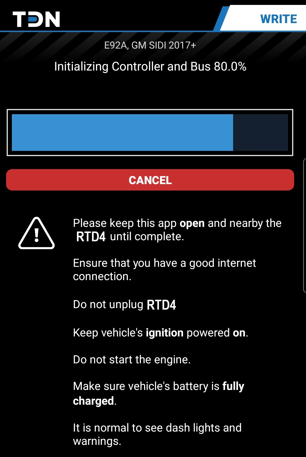

  8. Click OK to start the write process. The process is automated, but it may take several minutes, depending on the number of updates required for the interface device and the type of vehicle being flashed.
    A1 Image
    Caution
    • While the flash is in process, do not start the vehicle’s engine, turn the ignition off, or unplug the interface device. Keep your phone close to the interface device and connected to the Internet.

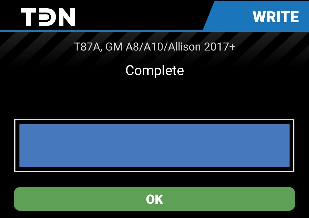

  9. When the write process is finished, a Complete screen is displayed.
  10. Click OK.
