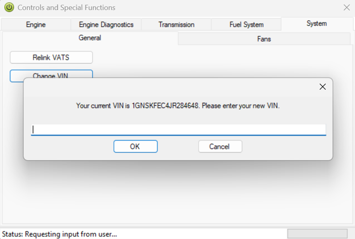

  4. On the top menu bar click "Vehicle" > "Controls & Special Functions" > "System" > "Change VIN".
  5. Enter the new VIN and click "OK" (refer to image below).
  6. If your new VIN is accepted, follow the Step-by-Step Instructions below.
