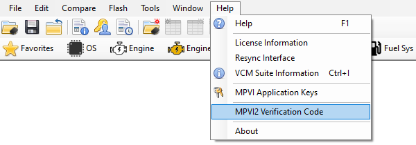

  4. In the menu bar, select Help > MPVI2 Verification Code.
  5. Write down the serial number and verification ID that the VCM software gives you (or keep the window open for cutting and pasting).

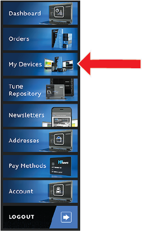

  8. Select the My Devices tab on your account page. You will find this tab located in the sidebar on the left side of the screen.

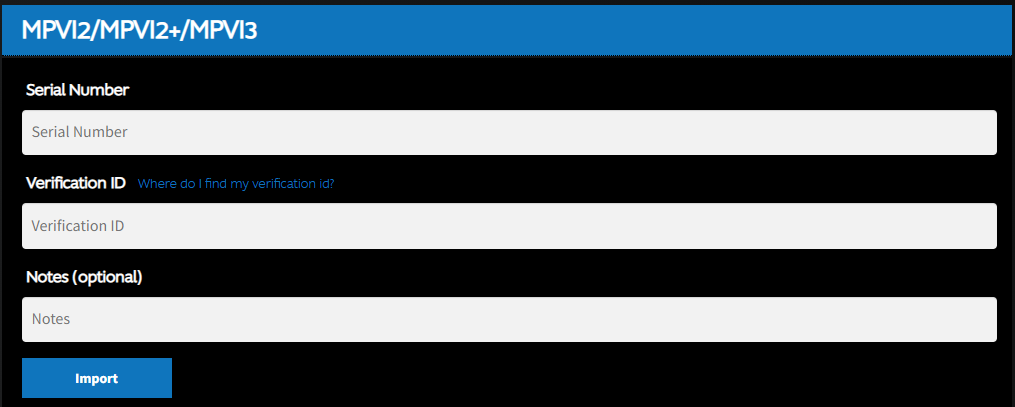

  9. In the fields under the MPVI2/MPVI2+/MPVI3 heading, enter the serial number and the verification ID you received in Step 4.

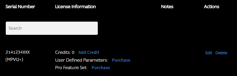

  10. Click Import. A summary of the new device will appear below the fields you just filled out.
  • If you have registered multiple devices, look for the new device's serial number in the column on the left.
