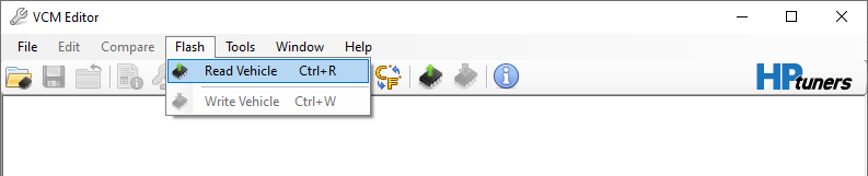

  7. In VCM Editor, select Flash > Read Vehicle.

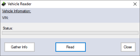

  8. The Vehicle Reader window appears. Wait 10 to 15 seconds.
  9. Click the Read button.
  10. Allow VCM Editor to read the vehicle controllers until the status bar indicates the read is complete.
