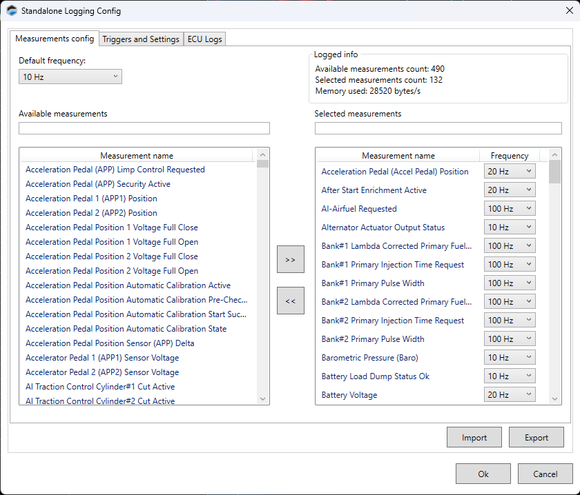

Selecting The Measurements To Be Logged🔗
  1. In the menu bar, select ECU > Standalone Logging Config. The Standalone Logging Config Window appears.
  2. Use the Default Frequency box to specify how many times per second the majority of measurements should be recorded.
  3. Select the measurements you wish to record. For each measurement you wish to add:
    a. In the column on the left side of the window, select a measurement.
    b. Click >> to move the selected measurement to the column on the right.
    c. If you want to record this measurement at a higher or lower rate than you specified as the default in step 3, use the Frequency dropdown next to the measurement to change the rate.

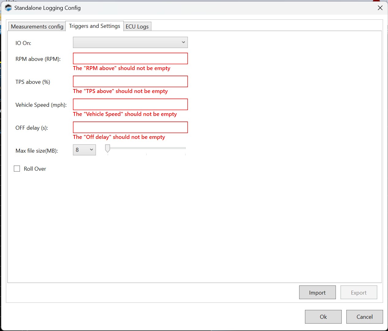

Defining Triggers and Other Settings🔗
The triggers to start and stop recording are configured on the Triggers and Settings tab of the Standalone Logging Config page.
IO On🔗
If you want to use a button or switch to trigger recording, select the ECU input that is connected to the switch you want to use. Recording will begin when the switch is ON.
If you don't want to use a switch as a trigger leave this blank.
RPM Above (RPM)🔗
The minimum engine RPM to begin required to begin recording.
TPS Above (%)🔗
The minimum reading of the throttle position sensor (%) required to begin recording.
Vehicle Speed (MPH)🔗
The minimum vehicle speed required to begin recording.
Off Delay (S)🔗
Recording will stop when one or more of the triggers fall below the values specified above for at least this amount of time (in seconds).
Max File Size (MB)🔗
The maximum allowable size for each log file. When this limit is reached, the ECU will open a new file and continue recording.
Roll Over🔗
This box specifies what the ECU does when its memory is full.
  • If this box IS NOT checked, recording will stop.
  • If this box IS checked, the ECU will delete its oldest log file in order to continue recording.

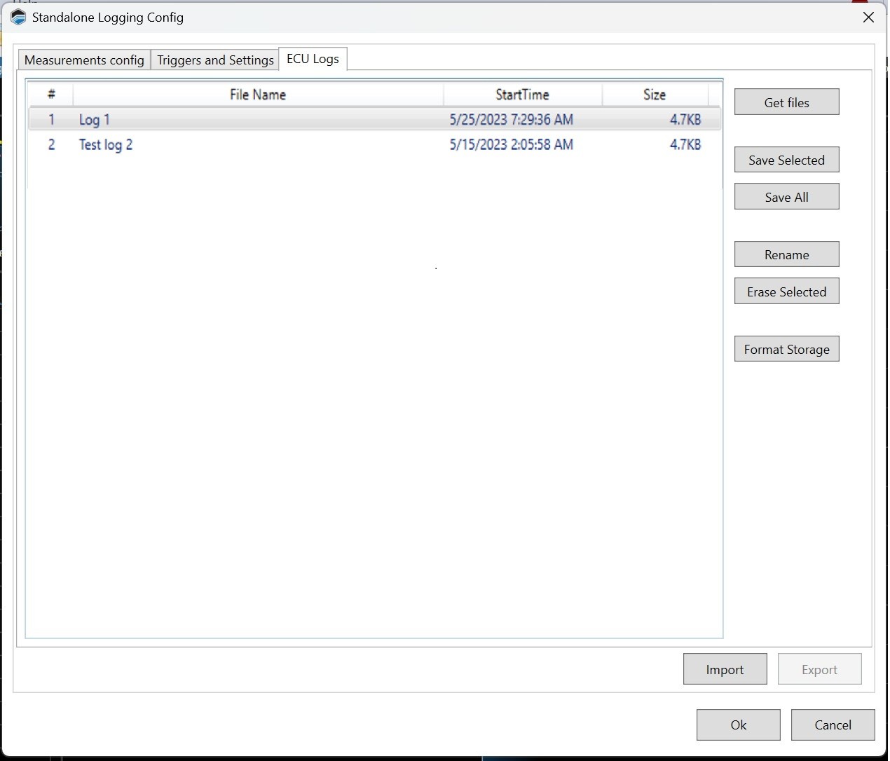

Retrieving Standalone Logs🔗
  1. On the ECU Logs tab of the Standalone Logging Config window, click the Get Files button. This will retrieve the list of log files currently stored on the ECU.
  2. If you want to rename a log file before saving it to your laptop, select the file and then click Rename.
  3. Save the log files you want by doing one of the following:
    a. Select the files you wish to save and then click Save Selected.
    b. Save all files by clicking Save All.
  4. If desired, you can free memory on the ECU by deleting the log files stored there. Do one of the following:
    a. Select the files you wish to delete and then click Erase Selected.
    b. Delete all files by clicking Erase All.
