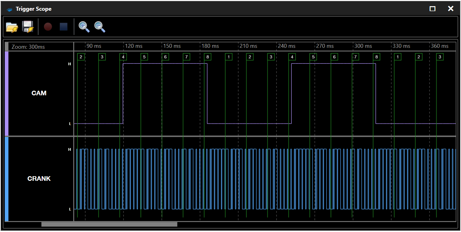

The Trigger scope window is useful when you want to examine cam and crank signals at a higher rate of sampling than is possible in a Time Graph subwindow. To open this window, select ECU > Trigger Scope in the menu bar.

Adjusting The View🔗
To move backward or forward in the timeline, click the graph and drag left or right. Alternately, drag the slider bar at the bottom of the window.
Use the mouse wheel to zoom in (view smaller increments of time in finer detail) or zoom out (view larger increments of time).

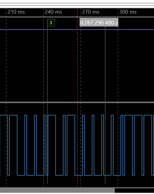

Moving To a Different Time Index🔗
To move to a different time index in the log file playback, do one of the following:
  • Left click allows you to move across the trigger scope.
  • Right click shows actual time on trigger scope.
