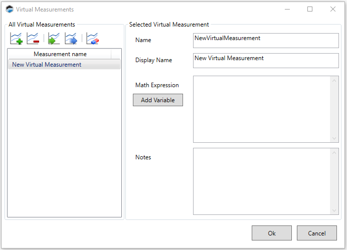

Defining Virtual Measurements🔗
  1. Click the icon.
  2. In the left column, select the new virtual measurement.
  3. On the right side of the window, enter the Display Name for this measurement. This is the name you will see displayed on screen.
  4. In the Name box, enter the internal parameter name used by the software.
    • This is typically just the Display Name with spaces and other special characters removed. It can be used to include this calculation in other virtual measurements.
  5. Enter the Math Expression for this measurement. This is the formula that will be used to calculate the new measurement. See Defining Expressions below.
  6. Click Ok.
