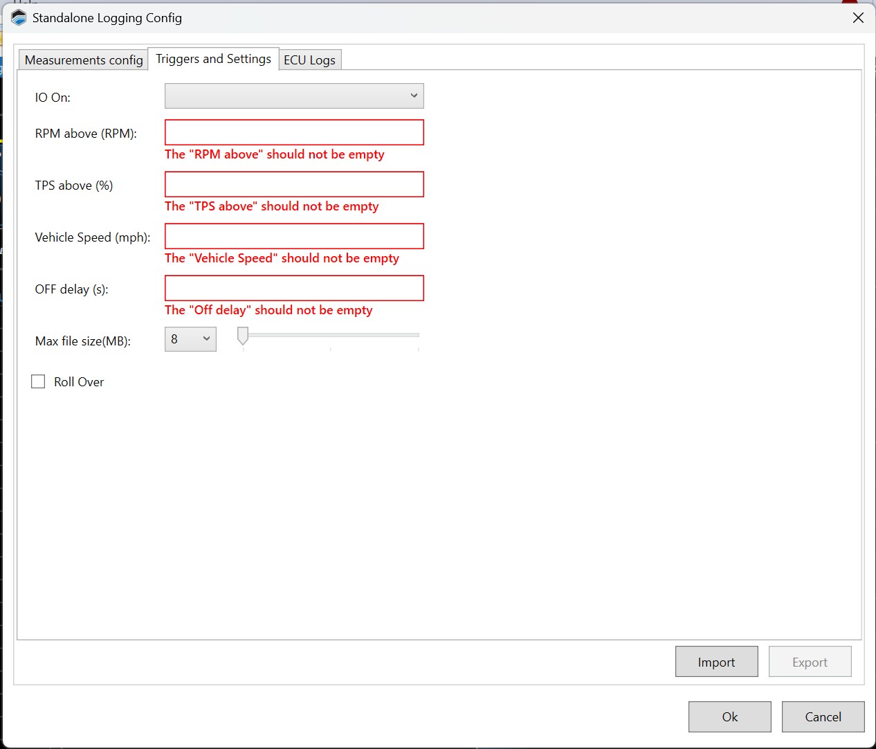

Logging Triggers and Log File Settings
The triggers to start and stop recording are configured on the top section of the Logging Config Window.
IO On
If you want to use a button or switch to trigger recording, select the ECU input that is connected to the switch you want to use. Recording will begin when the switch is ON.
If you don't want to use a switch as a trigger leave this blank.
RPM Above (RPM)
The minimum engine RPM to begin required to begin recording.
TPS Above (%)
The minimum reading of the throttle position sensor (%) required to begin recording.
Vehicle Speed (MPH)
The minimum vehicle speed required to begin recording.
Off Delay (S)
Recording will stop when one or more of the triggers fall below the values specified above for at least this amount of time (in seconds).
Max File Size (MB)
The maximum allowable size for each log file. When this limit is reached, the ECU will open a new file and continue recording.
Roll Over
This box specifies what the ECU does when its memory is full.
  • If this box IS NOT checked, recording will stop.
  • If this box IS checked, the ECU will delete its oldest log file in order to continue recording.

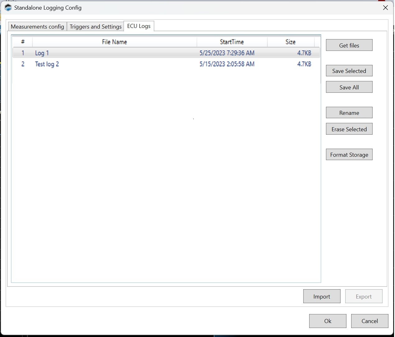

Retrieving Standalone Logs
  1. On the ECU Logs tab of the Standalone Logging Config window, click the Get Files button. This will retrieve the list of log files currently stored on the ECU.
  2. Use the Actions column to open the log files or open the file location.
